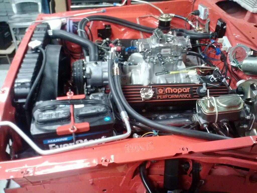

Need to replace the 22" radiator in my '71, 318 Satty. It currently has a 3574658 Mopar radiator which fits and looks factory, however that number crosses to an A body car. (and it's just a little more narrow than the B body 22" radiator. (bought the proper 22" B body shroud and it's too wide)
I'm wanting to replace it with a simple, normal, stock radiator. I'm concerned that if i buy the proper radiator for my B body, that it won't fit like this A body that is in it.

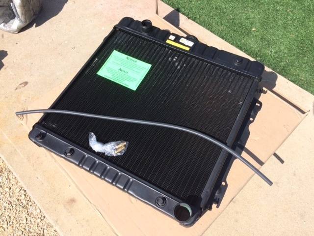

Ended up finding another nearly identical to what i had in there. Murray # 433511 $165. From O'reilly Autoparts. It is a Brass radiator !
Bolted up within 99% of the original, (had to bend the bottom of one side bracket about 1/4" outward to meet the bolt hole but it fits and looks correct. I didn't want a flashy aluminum radiator. It is supposed to come with a flange for the shroud, but didn't. I'll deal with that once i find a shroud.
I have a similar one the previous owner gave me for my '72 SSP. The radiator tag has the numbers 486 03 on one line. The second line has 433511. The third line "Made in Mexico". The 22" shroud I purchased from one of the repro suppliers kind of fits, but at the top it does not follow the radiator tank scallops and there is a gap there. Some day I might have a custom shroud made. (I purchased original metal shroud brackets (used) online, so I know the brackets are correct. The other problem I had was I can't mount the bracket for the repro factory style overflow bottle and bracket I purchased, things just won't line up there fastener wise.
