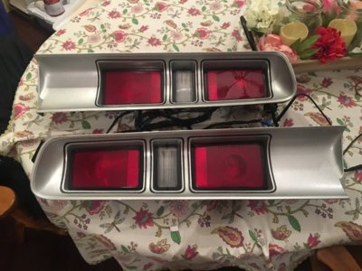

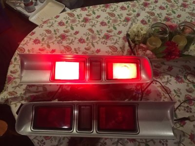

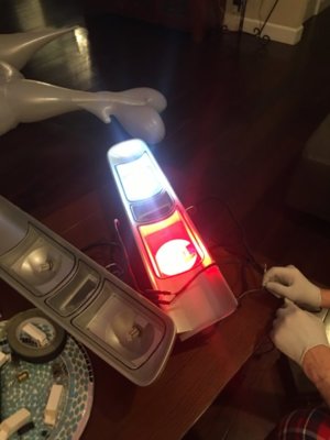

I used some like these in my tail light system build. I had to carefully get the old ones out, and would have really wanted to keep the old better ones, but these worked fine with small modifications. I got mine at O’Reilly auto parts (one and two wire). I coated all with flex seal to keep it water resistant.
