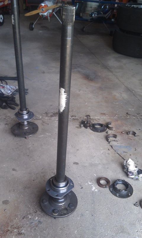

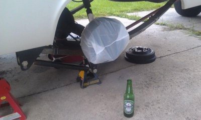

During an inspection of the rear end a few weeks ago, I noticed that the axles / wheels had a lot of "in/out" slop. I took everything apart and tried adjusting the axle adjuster on the passenger side. It didn't seem to even work, as if it were stripped out or something... I have a feeling that the center section I put in a few years ago never had the button in it for the axle adjustment to even work in the first place....
I bought the Moser kit to replace everything and also eliminate the need for the adjuster. I know there are a lot of people with strong opinions on this bearing arrangement on both sides of the fence.... I figured that with the miles I put on it a year, and the slow cornering speeds I have.... They will last a long time! They have to be better than the 45 year old bearings I just removed!
My 3 year Old and I pulled things apart this morning, removed the old axle seals, replaced the seals, and will be pressing the bearings down this afternoon.

Good news is, I got the axles put back in today too! It must not have had the spacer "button" in the diff, because the axle flange on both sides mounted flush to the axle housing. No more play in the axles now!!!!!

You don't need the thrust block/button with the green bearings, just need it for the roller bearings to properly adjust the end play.
