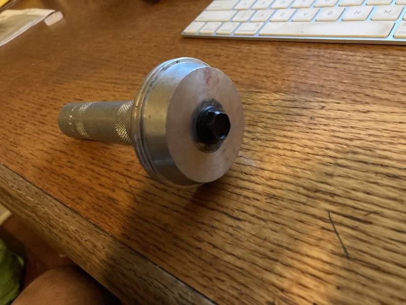

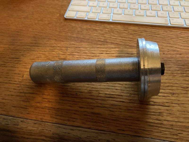

purchase the race installation tool kit. there are 8 or 9 different size pieces included and work very well.
if you try doing this without this tool you will mess up the races .
DO NOT try using an old race turned upside down, or use a bearing to seat them.
at some point - even you get them driven down flush what the hub lip, they still need to got down at least another 1/8" or so.
plus the tool can also be used to press in the seals in w/o f^$* them up.
just flip the race component upside down on the installation tool

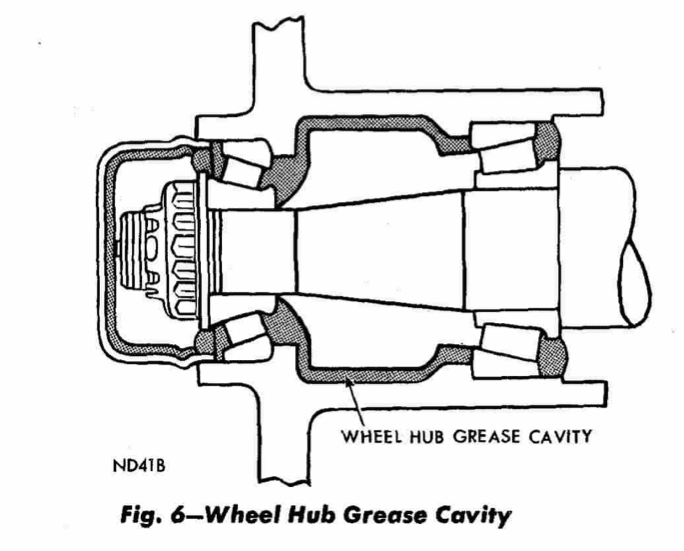

Do I just pack the bearings with grease and nothing more in the hub? or do I fill the hub with grease?
The service manual says "Fill the grease cavity with recommended wheel bearing lubricant"
you should put lubricant in the hub
however - don't over do it. When the assembly gets hot the grease loosens up and flows around.
Bill
If you are packing your new bearings with regular non synthetic grease and you did not have a bearing ( grinding or in pieces)
You can take a couple shop rags and wipe out that cavity and replace with new grease.
If you had bearing fail you will want to completely flush and clean the inner hub in a parts washer or a pan with solvent or fuel oil.
Do you know how to pack wheel bearings? You don't just smear some grease on them and install. THere is also a procedure for tightening the nut and getting the right load on the bearings. I was curious how the You Tubers would handle this. Well, there is some good information out there and some bad.
Clean the bearings well, inspect them for any damage, pack them by hand and smear some grease on the outside before installing them into the race. You don't need to fill the cavity with grease. It doesn't get into the bearings and just makes a mess. Install the castle nut and tighten by hand as you are spinning the drum. I always spin the drum anytime I am adjusting the nut. Tighten it firmly while spinning the drum/hub and loosen say a 1/4 turn. Spin and tighten again. I do this 2 or 3 times. With the nut wrench tight, not over tight, the drum/hub should spin fairly easy and smoothly. Grab the sides of the drum and pull and push in and out. If it's loose tighten the nut just a flat (1/6th of a turn) If it's too tight it will spin hard or if it does spin it will stop within a 1/4 turn. Finding the happy medium here is where you want to be. Put the cotter key in and if the hole doesn't line up loosen the nut slightly until it does. Remember. A little loose is better than too tight.
