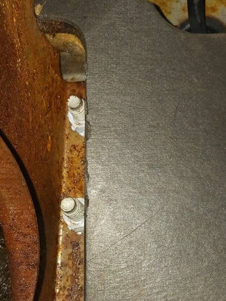

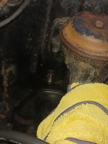

Noticed a small leak on the back side of the master cylinder on the 64 Fury. Needs replacing. Failed getting it off this afternoon, could use some advice..
Because the master cylinder nut access is in the cab under the steering colum behind the pedals and impossible to access (see photos -they are the corroded ones) I figured I would remove the entire plate under the hood (no brake booster) but again the rust. Nuts are rusted to bolt and both turn when trying to remove the nut. Any suggestions? Thx.
I PB Blasted and I am thinking about holding the bolt with a wrench and trying to wrestle off the nut tomorrow. I would rather not go primitive though.
Well you're not going to get it off otherwise. The plate is just a reinforcement. The 4 studs on the master go through the pedal frame and those 4 nuts have to come off. You can't just pull them thru...

Use a deep socket and wobble or ujoint and a long extension. 3/8" drive. Soak the hell out of everything with your favorite penetrant.

Douse the bolts with Gibbs lubricant oil. You'll be amazed how well it works. It puts pb blaster to shame.
Hold the head with a
wrench. Blast the nuts with
penetrant.
Break out the 1/2" drive
impact, an extension, and
a wobble socket.
They'll either come loose
or twist off. In which case
you can drive 'em out with
a punch and replace with
new. Don't fight it.

As a last resort you could grind the heads off the studs on the firewall side and punch them through or tack them with a welder so they don’t spin.
