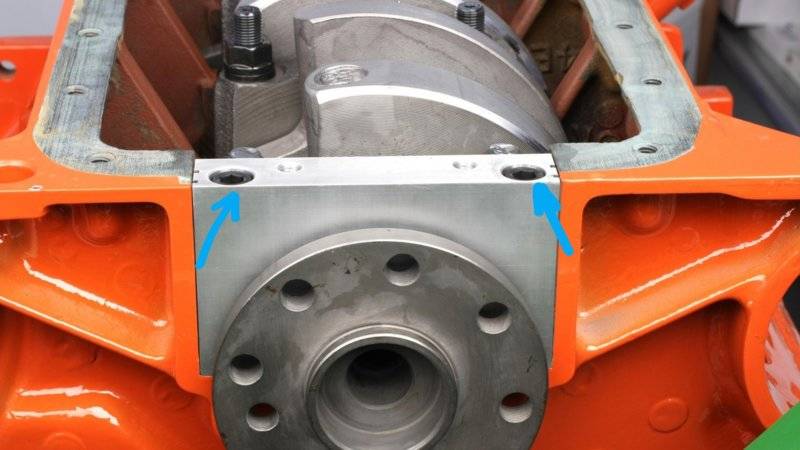

One more thing I didn't do and wish I did, fill in the seal retainer bolt holes level with sealer when putting the pan gasket and pan on. Some gaskets don't totally cover the holes and it leaves a void. That can allow oil to seep past the gasket.
I learned this from one of our great engine builders on here after the fact. I'll only get a small leak after jacking up the front for a period of time, then letting it back down. Wipe it off and it will stay dry until I jack it up again. Weirdest thing I ever saw until it was explained what was taking place.
Roger that...I did that before as well. That always seemed like another possible trouble spot..

2, stock retainer drill out the retainer bolt holes slightly oversize

(double check the two bosses on the back of the block where the retainer bolts screw into the block I've seen them chipped, (humps broken off)

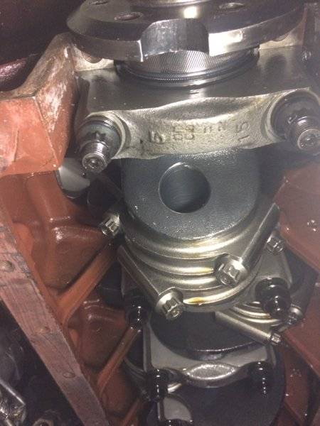

View attachment 775420 View attachment 775434
The rear seal GROOVE in many of the Blocks in NOT machined concentric with the Crank Centerline, some are just worse than others but ALL to some degree, in which case if the Seal is just allowed to "SIT" in the factory Block Groove "UN-adjusted" side to side..... one side of the Seal in the worst cases barely contacts the Crank(ANY Crank) = drip... drip... drip....
In our experience only,
On Blocks exhibiting this Groove offset however slight, you have to offset the Seal Halves 1/4" from the parting line, then use the "side to side" clearance in the Factory Seal Retainer itself(all we ever use) once installed but NOT yet tightened.... to then DRAG the offending non-sealing side in the Block over into Crank contact... by applying light pressure with a small screwdriver on the side of the Retainer as you tighten/Torque the Retainer Bolts.
Typically we adjust the Retainer toward the Driver's side of the Block.
We then TEST all BB Mopar Rear Seals for leakage after we assemble the Engine, BEFORE we Dyno them, or Heaven forbid allow a leaky Main to get to a Customer
(NOT GOOD !)
I would suggest anyone else reading this should also TEST their BB Mopar Rear Main Seals BEFORE installing their Engines in the Car, because it's FAR EASIER to re-do the Seal if Required while it's still out ?

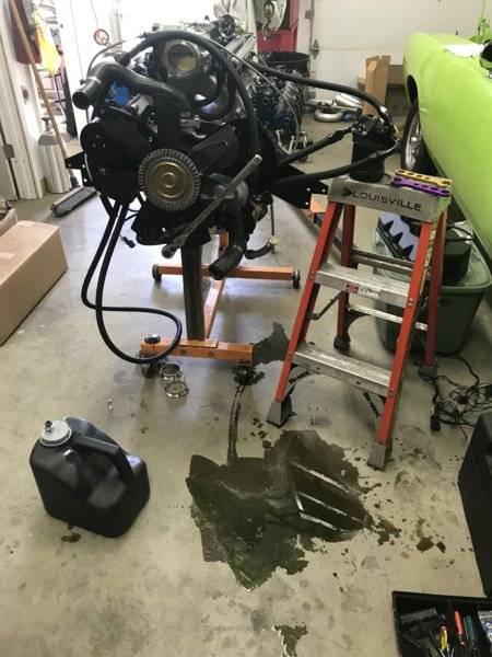

OK I will offset the ends thank you! And yessir, hanging the block nose up is how I confirmed it was the seal that was leaking...took about 90 seconds to run out once the oil was sitting on it. Thanks again!
Hopefully you put a drain pan underneath! A little oil goes a long way on the floor!
Yeah, right? Especially this gooey, slimy break-in oil...it's like syrup with a layer of bacon grease!
Not the rear main but a mess none the less!
