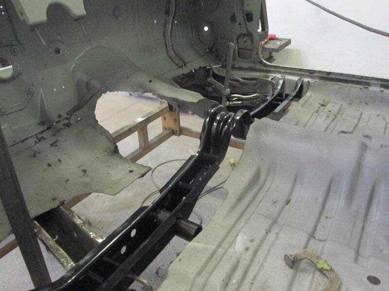

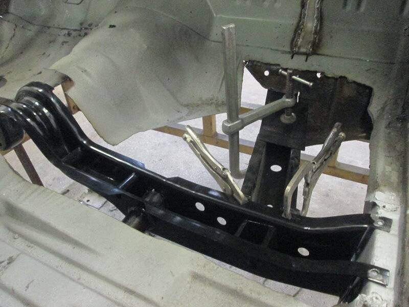

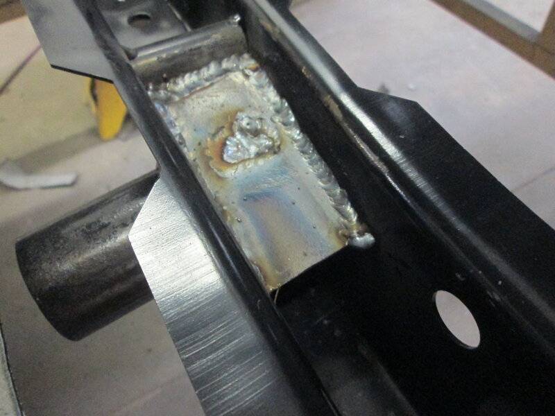

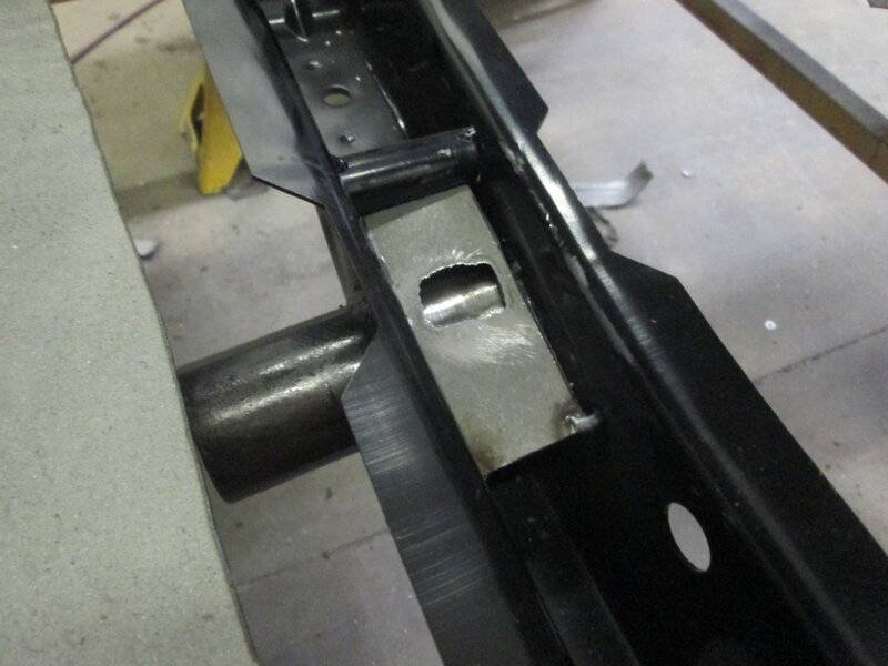

Take exact measurements of where the cross member is before removal and replace per measurements. Reinforce the socket ends while in there..

Ok thanks for advice....so i dont need to have torsion bars installed for any alignment...
I will take some exact measurements .... !!
Great advice for the reinforcement , had no glue about that , great idea !!

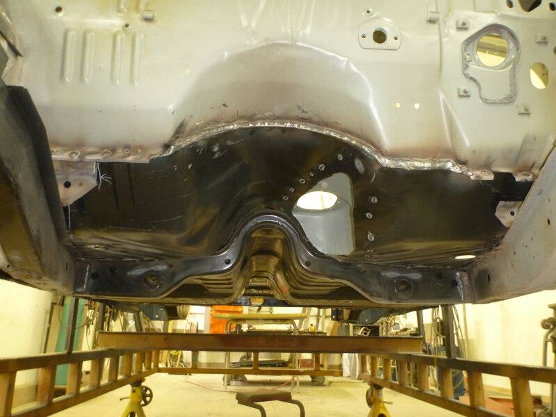

Did you install the crossmember also with spot welds only ?? like original
or did you fully weld it in ?
Thx

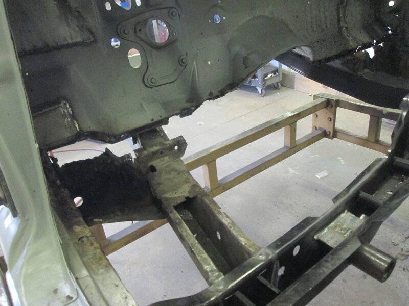

You will also want the car either on a jig or solidly supported. Some temporary cross bracing wouldn't hurt either. You don't want anything to move when it gets cut out.
i dont have a jig ...but will add some cross bracing.
the car is sitting fully disassembled on a lift ...... hope this is ok ? i am bit worried about

Welded similar to OE and anywhere else we could get a good weld on it.
