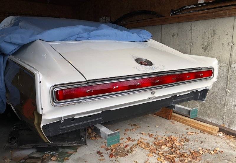

Ayuh... The trim for the deck lid never had a seal or a gasket of any kind, but I may add one to mine... Bees Wax or RTV at the threads, or a perhaps a strip of 3M Automotive Molding Tape applied to the back... anything really that will help keep moisture from entering the bottom of the trunk lid... you know, the famous area where all the rot and corrosion starts on these deck lids.

Yep. I'm doing something similar (threads and backing). I do fab and paint at a sign shop. Keep up the good work!
Trim pieces installed with the new gaskets I made... looking good :thumbsup:
