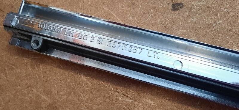

Reverse markings
OER:
PG Classic:

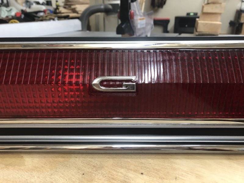

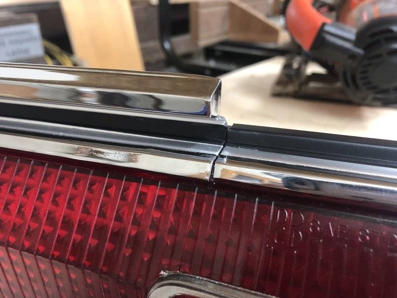

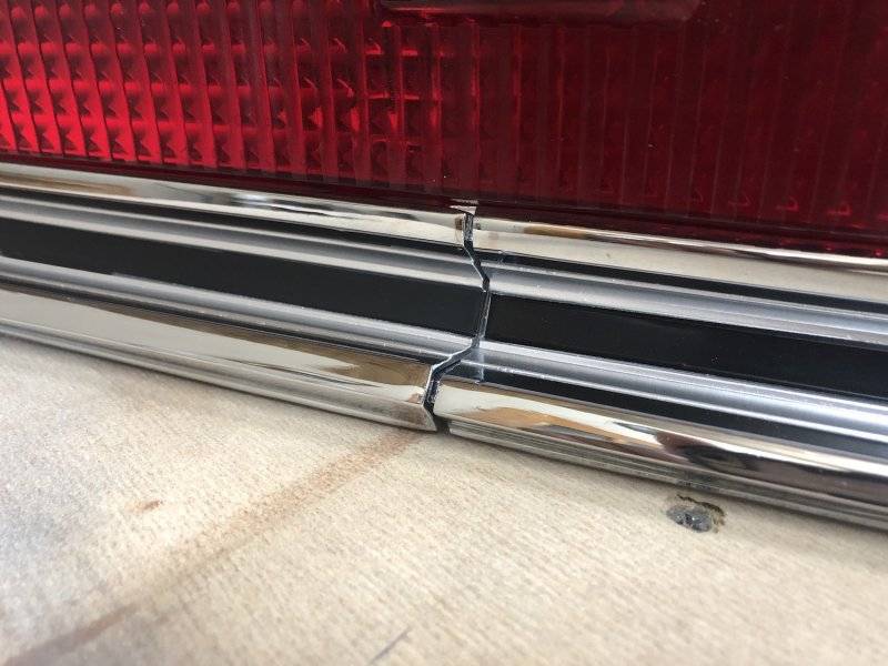

I just started looking at this issue myself. All of my shiny new trim pieces were purchased from Van's, but they are not the same. As you can see in the top two attached images, the paint on the outer "C" pieces is different than the other two inner pieces. I think the easiest thing for me to do here, would be to mask everything off, and surround that inner Black section with Argent Silver, as seen in the 3rd image.

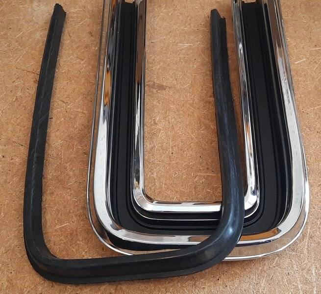

On a side note here... I also made a set of models & molds to reproduced the gaskets for these pieces. As mentioned above, some of the "C" kits come with gaskets, but if you only need the gaskets themselves, you're pretty much out of luck. There are no gaskets available for the long top and bottom pieces either to my knowledge, so.... Since I'll be mounting my lens assembly on my recently restored Charger here pretty quick, I needed to make molds for them.
Original Gaskets are highlighted in Purple in the image below

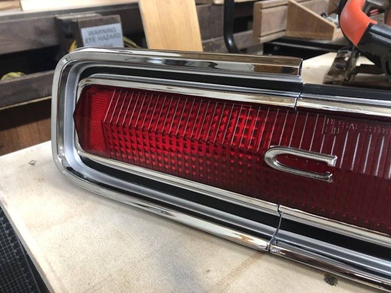

Okay... I'm pretty happy with the end result here. Masking everything off was about as much fun as getting a tooth extracted, but it didn't take all that long, maybe an hour. It's just painstakingly tedious in a case like this, which is not something that I enjoy.
It turned out looking pretty good though in my opinion, so I guess it was time well spent. It's pretty easy to see the new silvery paint in the pic's, but under normal lighting conditions it's actually fairly difficult to tell where the Chrome ends and the Silver starts.
Either way... the assembly is finally ready to get bolted onto the Charger now, utilizing the new gasket kit I made up.
P.S.: Should anyone need a set of these gaskets in the future... you know who to contact.

That turned out awesome!!! :thumbsup:
That looks great! I will pm you for the gaskets and the cost when I get ready. I'm slowly getting there, one weekend at a time.

Being a detail oriented guy myself, I really appreciate the work! I'm especially glad that you are molding the gaskets. Thank you.
Personally, however, I've worked on a few original-finish trunk lids (working on one now) for these cars and I have never run into a lid gasket (or remnants) on any of them. I realize that it's in the parts catalog diagram and frankly, should be there, but I have not run into one. Not saying that there weren't any...just my experience. I'm glad you are producing one, regardless.
Cheers! Tom
The gasket is for the top long piece of the taillight assembly, not the trunk lid.
