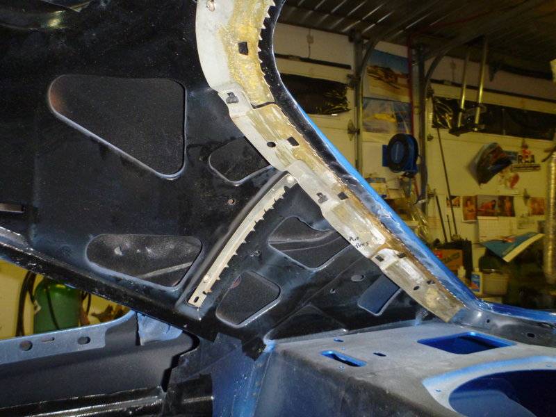

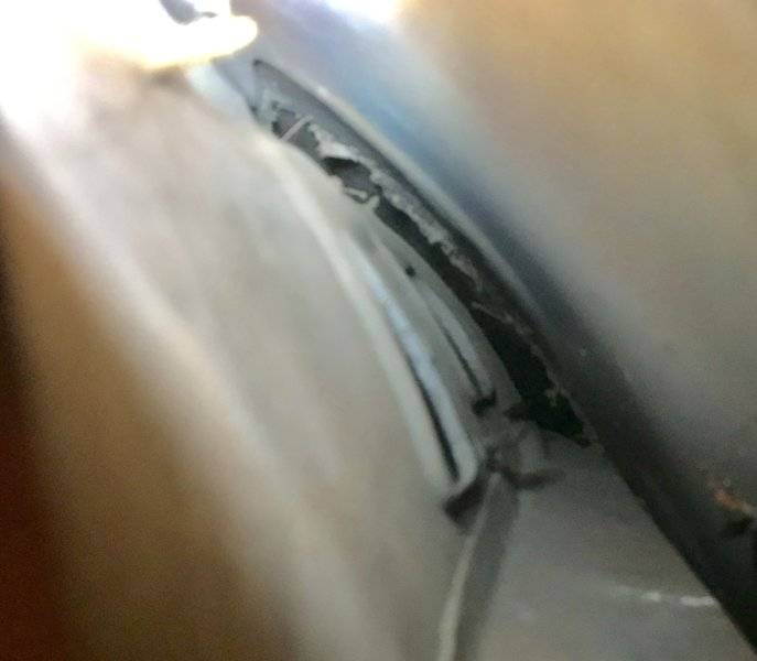

Here you guys go... For reference, this is looking from side of trunk up into the c-pillar area. The weld extends from the lower corner of the side window to about half way up the back window. The weld is pretty rough with a lot of wire hanging off. Also looks like there is lead that has seeped through from the seam applied from the outside. The other side of the car is consistent with this as well.

it looks like something was replaced to me...
Never seen an original roof car look like that on the inside.......The lead never "seeped" through.....
Those welds were all spot welds from the factory. So if there's "wire" it ain't factory. And FWIW, ya can't believe everything the guy selling the car tells ya.
Through the roof frames interior holes in the back of the C pillar. probably 3 foot "tongs" on the welder.

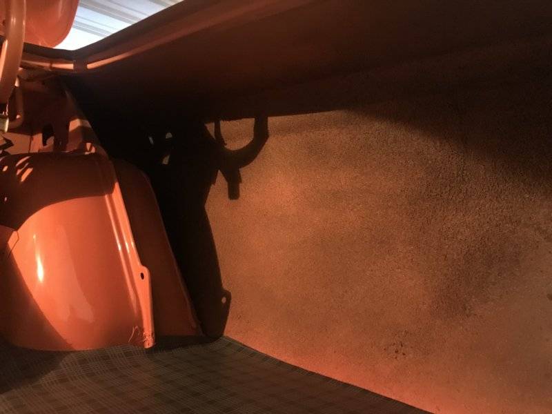

I can get you a pic from inside my GTX tomorrow

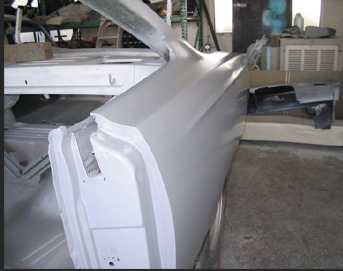

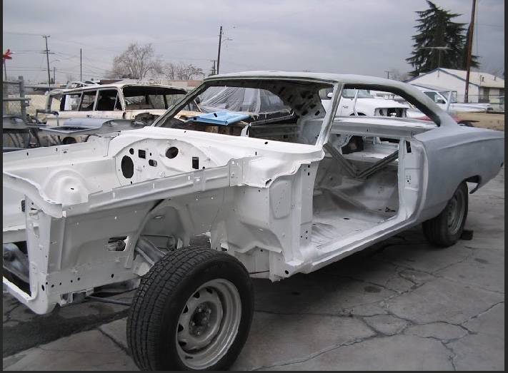

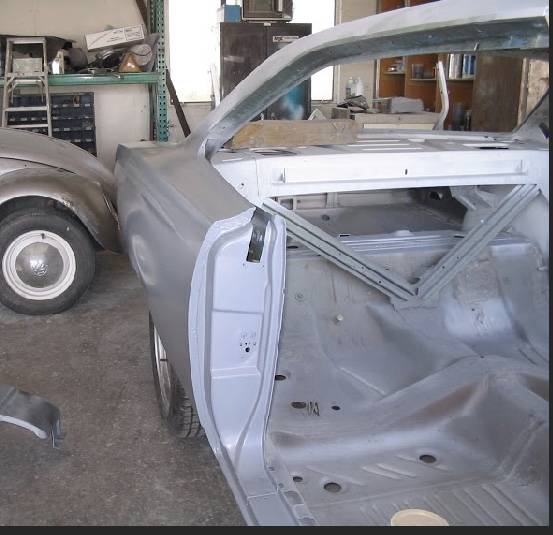

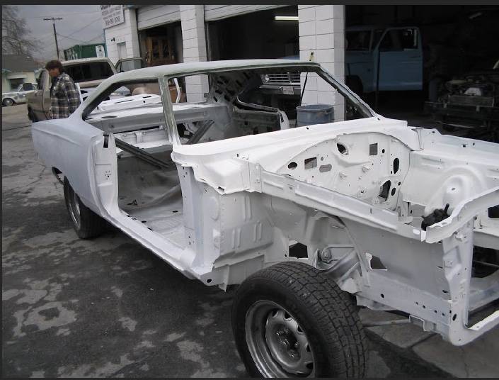

Here was after full walnut blast and start of epoxy coat. Car was originally green per fender tag
9F02A0BB-B1AC-4A44-B72B-6204E38EFF55.jpeg 876F318F-3577-495D-8F3D-62D4768C8449.jpeg 1BF11C61-F2BD-4AEA-A89F-AB9071E015DD.jpeg A7391AC3-3F8E-4028-996C-6629E4AE675E.jpeg
