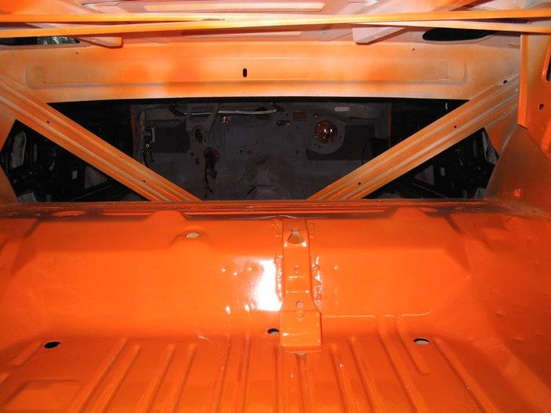

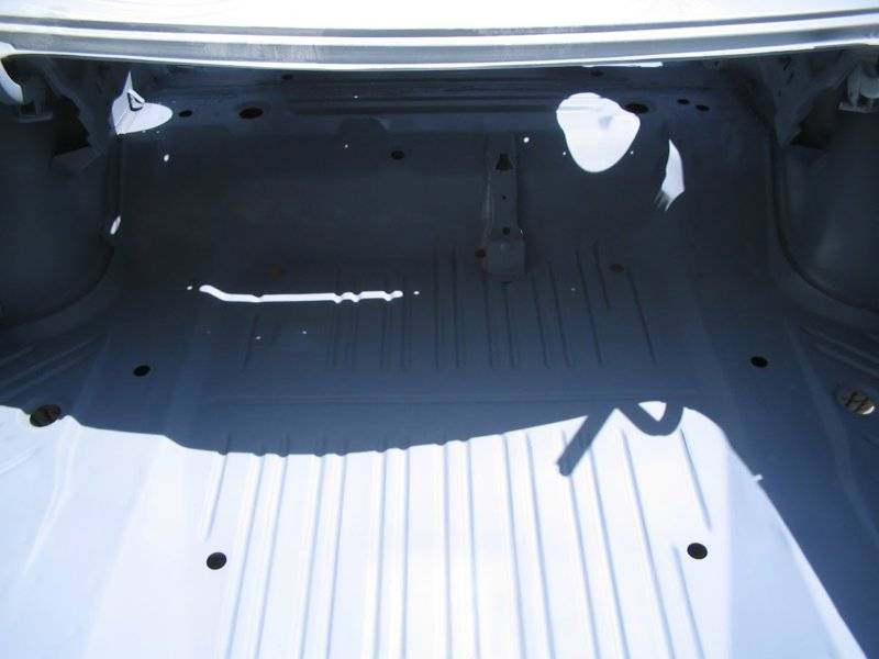

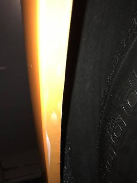

requesting picture of factory weld roof skin to quarter panel 69 road runner
I'm pretty sure the quarters were changed out

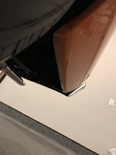

the outer lower tabs are missing on the trunk extensions on both sides.

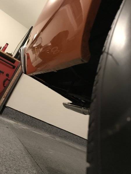

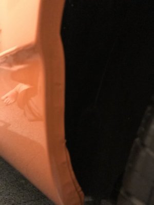

where the driver quarter meets the drop........ looks like the edge of the drop was trimmed back.......like I said, its all about the spot welds, they may be buried in filler and paint, but should be visible from the other side
in front of the wheel bottom pinchweld, wheel opening, trunk gutter seams.......... pics are tough to see detail

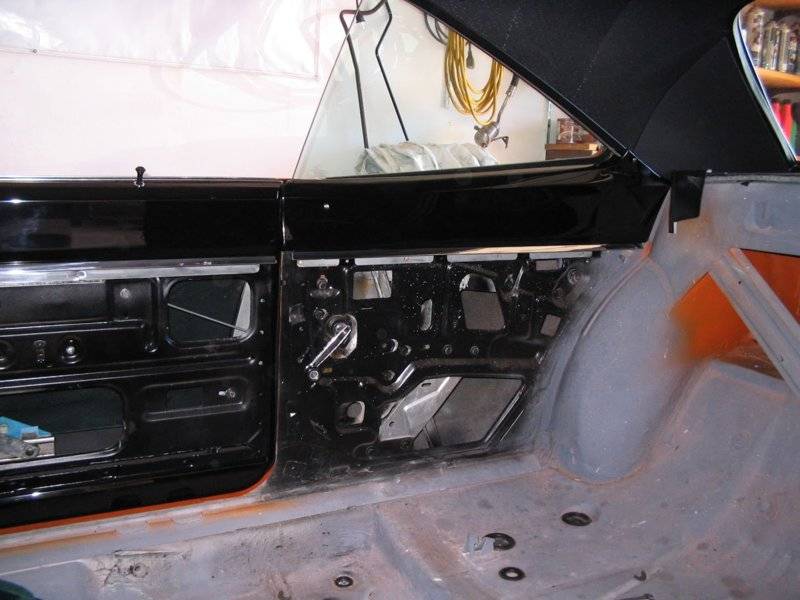

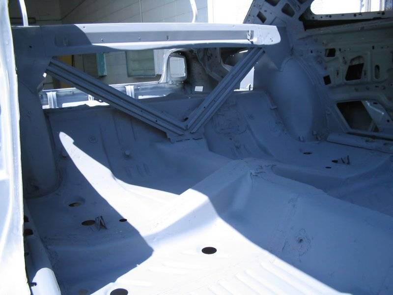

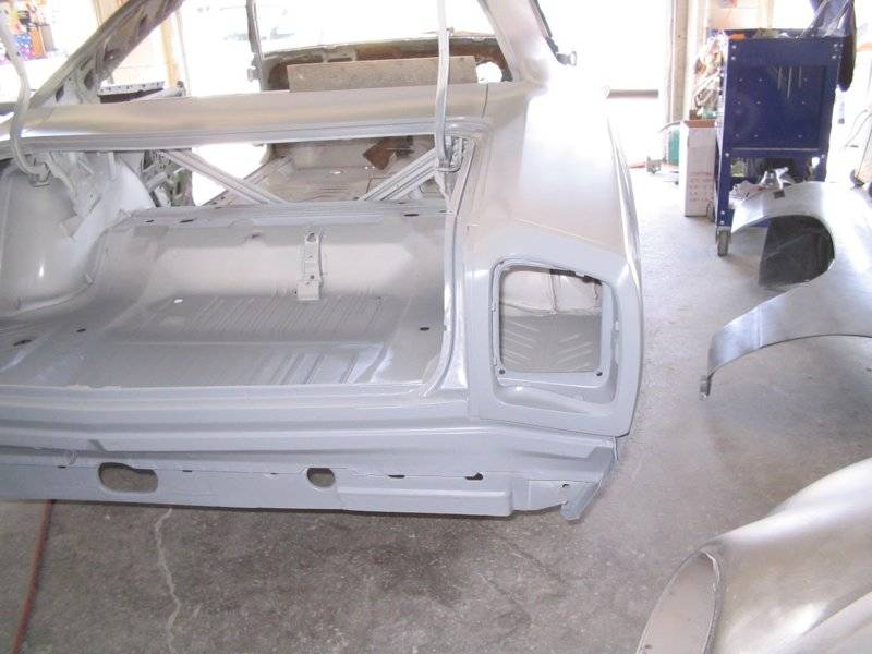

found a few more on my computer of the resto....
road runner 13.jpg road runner 22.jpg road runner 25.jpg road runner 41.jpg road runner 67.jpg
I'm beginning to wonder what the point of this thread is !!!

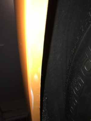

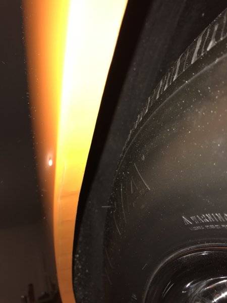

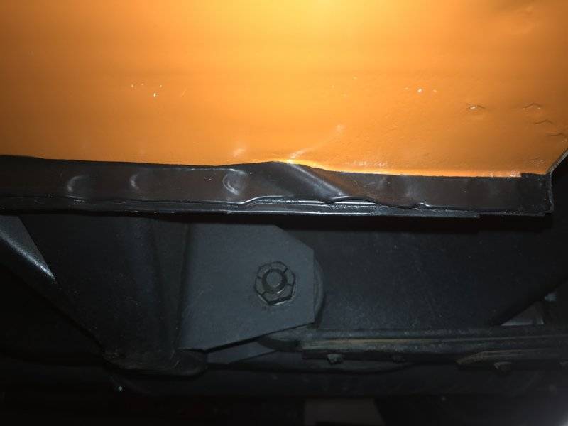

Is this a Grave Yard cars resto? I ask considering that after an extensive strip / paint / etc the entire underside, springs retainers, shackles and all has been sprayed in black.. .and they have a big spot welder.
whoa...the bottom of the quarter is LOADED with mud!..
