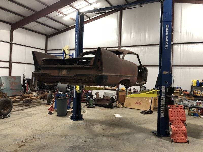

In 2015, I paid about $3,000 for a Bendpak 2 post assymetrical extra tall clear floor 168" lift, 10,000 lb certified. Looks like a similar Bendpak lift is $4,500 now. I think the Chinese lifts start around $2500. If I remember right, the requirements were minimum 4" 3500 PSI concrete. Power is 240 VAC at 20 amps, maybe 30.
If you don't have the minimum concrete requirements, the instructions for the lift will tell you what to do. You will have to dig footers to a certain size which requires cutting into the existing concrete. And if you're going to do that, you might as well get a lift with a floorplate (hyd hoses and cables run along the floor instead of overhead) so you can pour the new concrete an inch or so below existing for the floor tray to sit in. Then you'll have the best of both and won't be limited with taller vehicles like vans (I've heard they're a lot more common in Europe), or have a speed bump in the way.
As far as ceiling height, here's a 9,000 lb lift designed for low ceilings for $2,700, columns are 9'3":
https://www.tooltopia.com/Atlas-Equipment-ATEXH9KBPX
Symmetrical lifts are more stable, but don't have as much room to open the car door. I chose asymmetrical. Some lifts come with fancy arms that let you achieve both.
