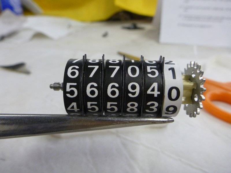

Started on the dash restoration for the RR, want to zero the odometer, anybody have any good tips for doing this without breaking it?
Without dissasembly it? With a drill.
Dissasembling? Tipically is held by a clip on the opossite side of the gear. Remove it and then turn by hand each wheel, althought it can be somehow tricky. Then reinstall.

I managed to get mine zeroed and tested, was not hard getting the cluster out and back in. I never did figure out a proper sequence or algorithm to turning them in relation with each other, I just kept futzing around with it like a rubiks cube.
As mentioned above I am exempt from odometer disclosure in my state. Actually, all the licensed vehicles I own (three cars, a truck and an offroad frankenstein) are exempt.
Since I've never changed or altered an odometer, it's possible to reset the number without disassembly with a neat trick. Or, it can be disassembled and reset. Again... I don't recall ever doing either method. The reverse drill method is very long and arduous... I've heard.
MANY get reset to zero during a complete restoration... whether that is right or wrong. Easy to do while you're putting new numeral labels on.
It's not too hard. Look at this video about 1/3 of the way in.
