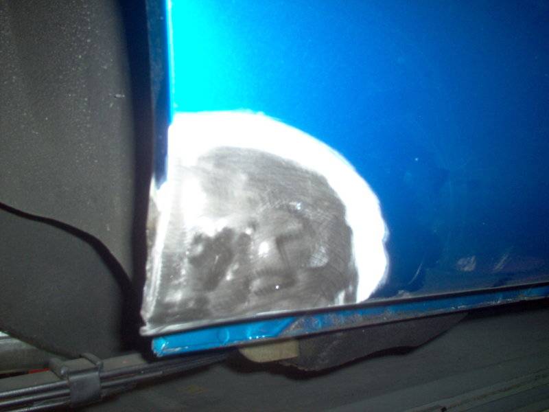

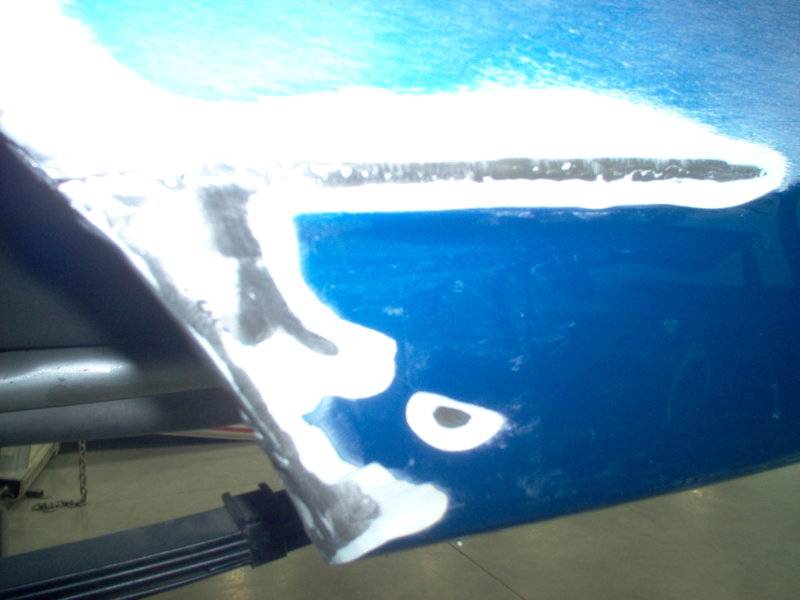

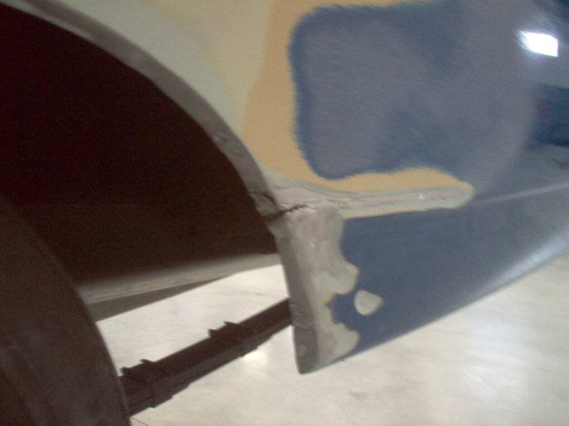

This is how "Restorations by Julius" handles bodywork. Backstory: cracking paint, a few polite calls & discussions with Julius, who remembered the car.
He provided no answers or even consistent stories, only "never had a problem".
The bodywork & paint was not tampered with since leaving his shop.
Finally started digging into it, and this is what we found (quick & sucky photos):
Lt quarter lower patch panel barely welded, and beat on apparently with a ball-peen, then over 3/8" of bondo on top.
A few rust spots on the right, a good 1/4" or so of bondo over that.
Other areas with no damage underneath, also 1/4" of bondo.
I'm utterly mystified as to why, let alone the sheer nerve involved in such crap work.
Bonus points: missing parts, incorrect fasteners & finishes, etc found during disassembly.
Rest assured the car is going down to the bone and being re-done.
