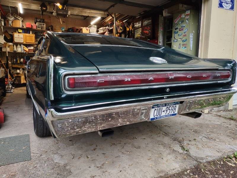

I bought an amd front bumper for a 67 gtx at Carlisle, after I looked at it that evening I returned it the next day. Weak chrome no depth, the way they terminated the shape was not like original, as the plating ended at the end the chrome almost went to gray color.

AMD bumpers are okay for a driver these days. Chinesium craftsmanship and attention to detail. In short, they suck. Double chrome.
