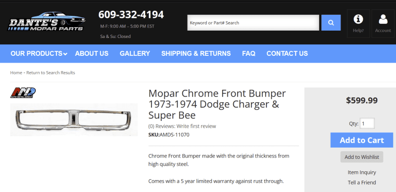

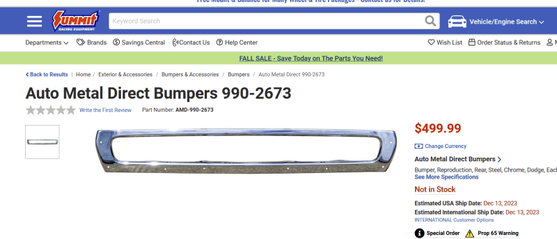

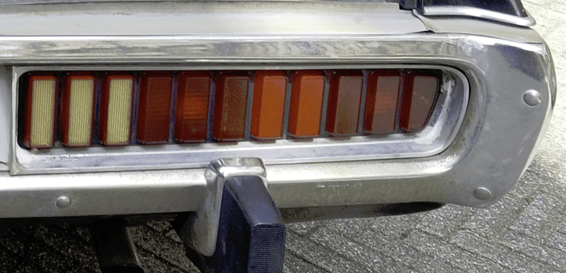

So, I want to restore my bumpers front and rear or may get some reproduction ones. So I could use some advice on this.
- And if repro's are considered, where to get them and where not for any reason. Do the repro ones fit well and ar all the holes and slots in the right place? Who has seen that and been there? What to expect?

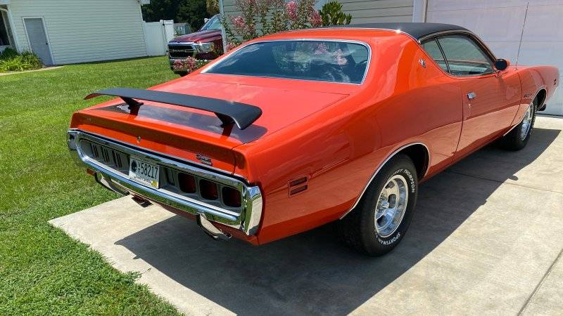

This is an AMD repro. Fit is dead on. As mentioned its a bit lighter then original. When I got hit in April the original was sent to Tri-City but the turn around would have made me miss Carlisle so we put an AMD on. It is still on the car and my recromed one is in the box, I will swap them at some point but it looks and fits great so no hurry. The bill from Tri-City was $900 plus shipping so there is that factor.
