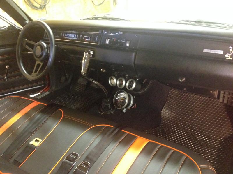

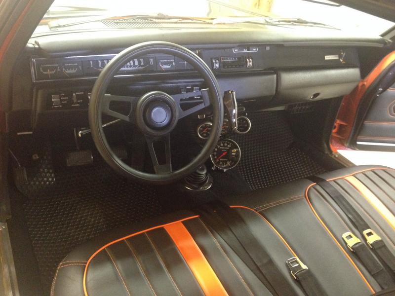

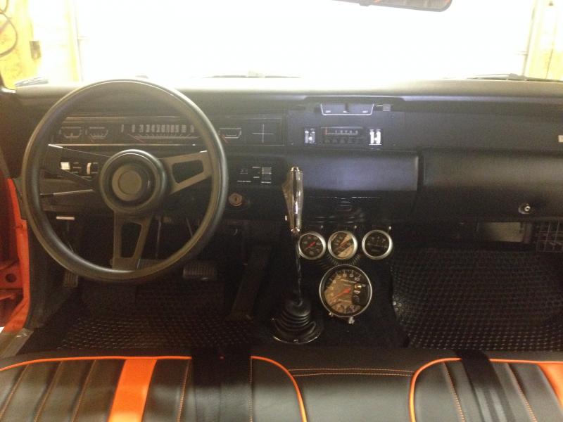

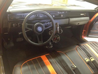

Removed/painted lower dash pad, removed/painted dash controls, replaced instrument bezel, installed correct radio, replaced steering wheel, painted steering column and dash.
I also had the upholstery done at the same time.
WHat did you find the best method was for painting the dash controls? the eraser as recommended?
Upholstery looks amazing and I love your steering wheel choice!

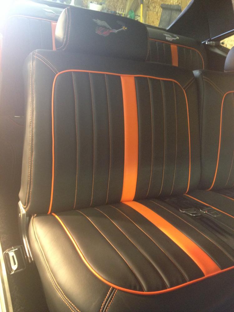

That interior looks great and I love the orange accents on the seat with the roadrunner on the headrest.
Who did your upholstery? I love the roadrunners on the headrests and the orange accent stitching.
