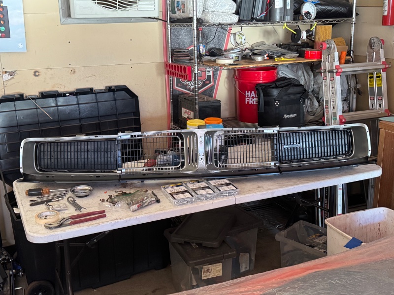

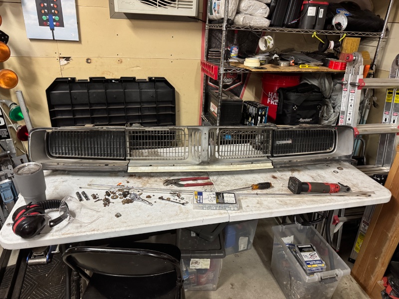

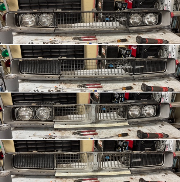

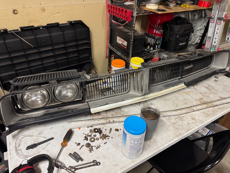

Restoring my 68, soon to be 69 grill I’m not trying to get it to show quality, just wanna give it a refresh to make it look respectable. What’s the best way to attack this? Simply rattle can over it?
I also have some plastic cracks to seal. JB weld? Or a stronger, better option?

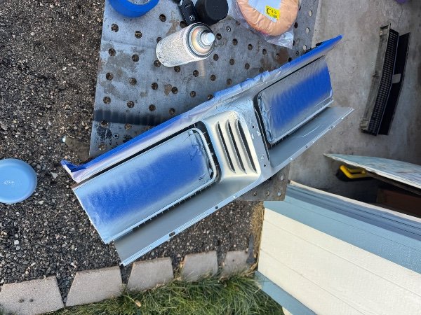

SEM adhesion promoter after cleaning with wax and grease remover after scotch brite. I used rattle can and steps above worked for me

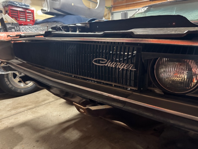

First off, I'm confused. You note: "Restoring my 68, soon to be 69 grill"... Uh, the two grilles are different. Are you saying you're trying to make a 68 grille into a 69 grille ?
Oh yeah, picking up one of these cheap on fb marketplace. Not sure what else is involved in the conversion outside of the chrome, but we’re gonna make it happen.

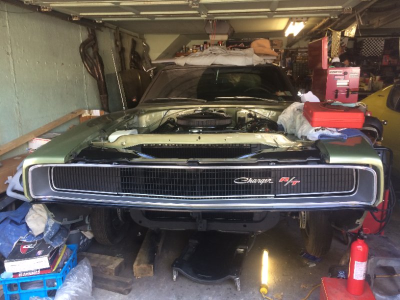

Howdy When I repaired my 70 Charger grill I used PlastiFix it worked great. Now it took a lot of filing and sanding and painting, spray can, lots of testing to get the colors that I found acceptable. I've asked people to find the repairs no one has so far.

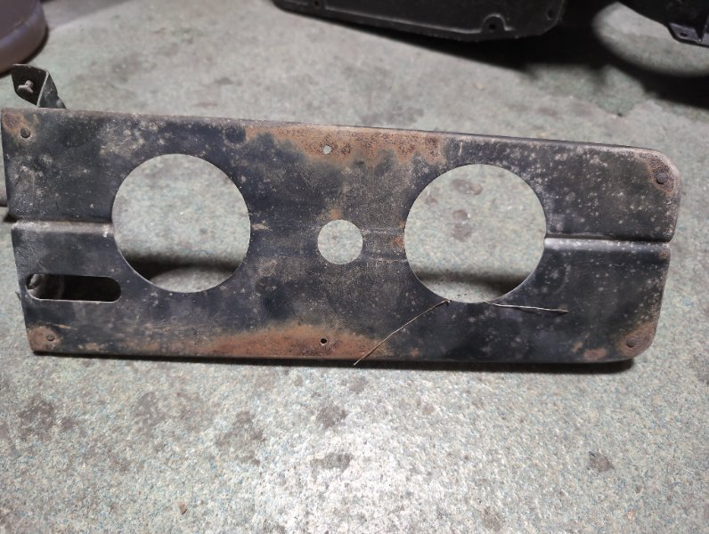

1. Anyone successfully separate & reattach the plastic from the headlight door metal frame? There are smash rivers holding it in place and I'm wondering how much rust is behind it & is it worth the trouble?
2. Has anyone soda or walnut blasted them to clean off all the old paint? If you didn't can you see differences where the paint is chipped/worn between the fins?
3. I've seen different people say Semi-gloss & Gloss for the black. Is there a definitive decision what it should be? I read the David Wise judging manual and it's not specifically mentioned.
I have a spare grill (worse shape than mine) that I'm going to test the 3 questions on to see how it goes. One of the doors had sheet metal screws holding the plastic on the door frame so easy to try re-riveting it. And yes there was rust behind the plastic near the rivet holes.

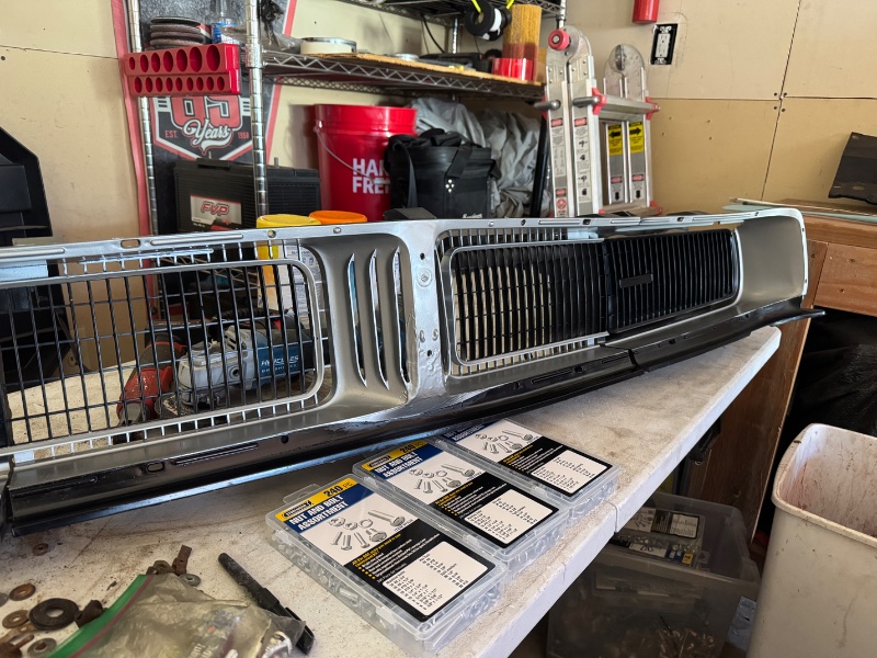

Appreciate this thread. Starting my conversion/restore now. The only thing I’m noticing right now Immediately is that the hood latch release is in a totally different spot, thankfully, because it’s a race car, it doesn’t even apply.

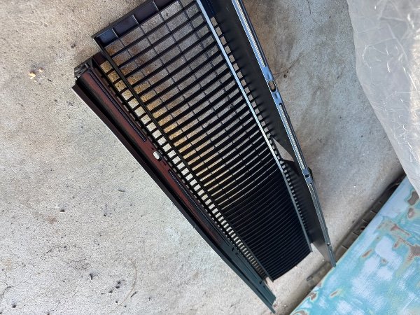

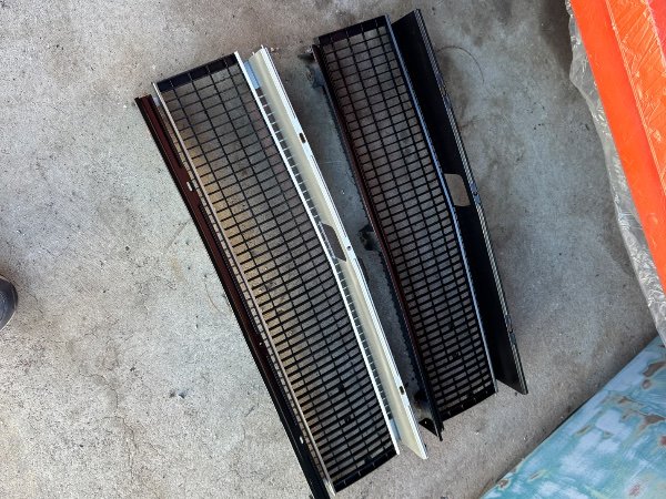

Color wise, I went with a recommendation of satin black from rust oleum for the black and the Krylon aluminum color spray. We’ll see how they turn out.
Also unsure, I know every grill plastic centerpiece that I’ve ever owned had black on the bottom, this one is white for some reason. Not sure if a previous owner did that or what? Will obviously be painting over it.

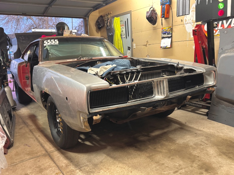

Amazing what a little bit of paint will do. Decided to just paint the rest of my front grills. Still have touch up to do yet
Decided to do a blacked out 68, silver and black 68 and silver and black 69.

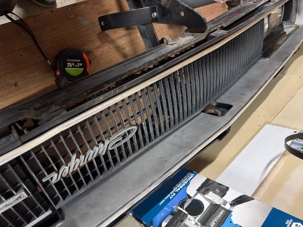

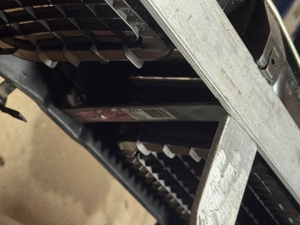

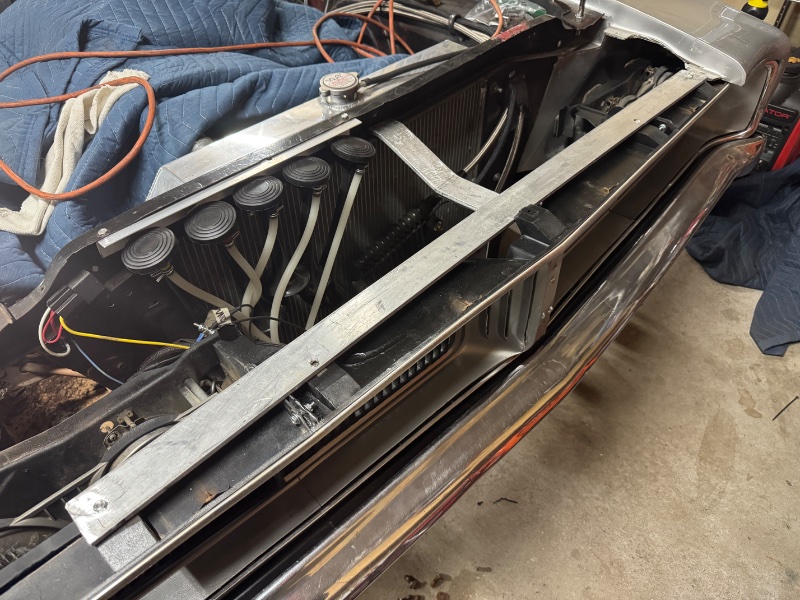

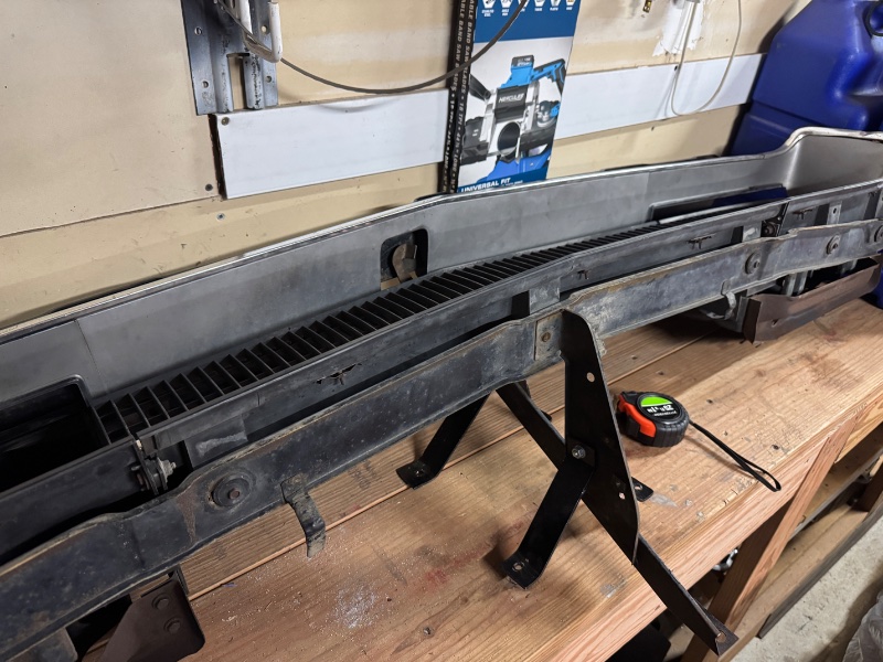

Last update, building a more simple and new mount for the front end. It was pretty flimsy to start so ditching some of the old hardware and mounting points.
Going to tig up some flat stock aluminum that’ll connect not only across at the top but to the bottom runner all the way across. This also mounts to the radiator support. For the Race Car application with liftoff hood, it is unnecessary to have the top hood latch and entire cover. However, if I wanted to go back, it would be a very simple fix. Cosmetic removal will simplify the front end and make it structurally more sound while losing a teeny bit of weight.
