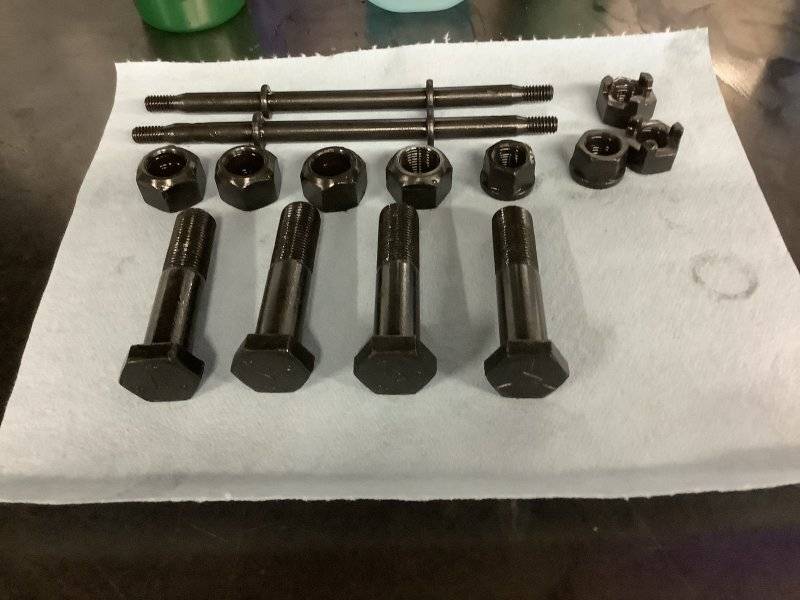

Lots of folks use Mineral Sourits for degreasing, a wire wheel on a bench grinder, a tumbler and abrasive media and different kinds of finishes depending on the fastener. Most nuts and bolts are just steel with iron oxide for rust protection.
Boeshield is a great rust protection.
For the body nuts and bolts My plan is clean and paint them,if need run a die or tap threw them. .
Evaporust will make plain fasteners look like new. It does not touch paint, though. Anything that gets painted goes in the sandblast cabinet.
Sandblast, wire wheel, steel brush, and usually by hand. I have never been too concerned with restoring them to factory-new appearance, as when I was working on my cars, I just wanted them to clean up nicely and then thread chase the nuts and bolts to clean up the threads. cr8crshr/Bill :usflag: :usflag: :usflag:
I clean and tin/zinc plate with eastwoods plating kit. to keep the rust away.

Yep Caswell and zinc and nickel plating and RPM Does a lovely job! After glass bead blasting. Well worth the effort. And I mean really; what a great way to spend some time. Becoming one with your blast cabinet. lol
