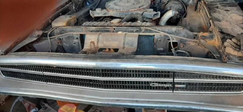

Thanks - it's a couple of states away. My dad is slowly "finding/unburying" it from his garage. I've attached the front as he's working front to back.
