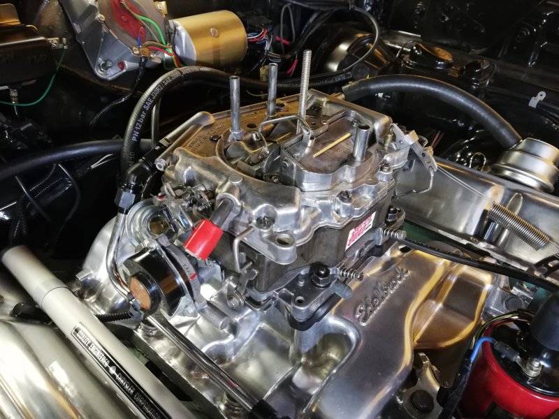

On my 440 4 speed car I used a Edelbrock performer intake 2191 with a ThermoQuad carb the range is idle to 5000 it made a ridiculous amount of torque. I never tried the RPM intake.
Thats what I am running also. Crazy bottom response, mid and top.
The Street Demon came in second place, though a simpler carb to work with than the complex (But awesome) TQ.
