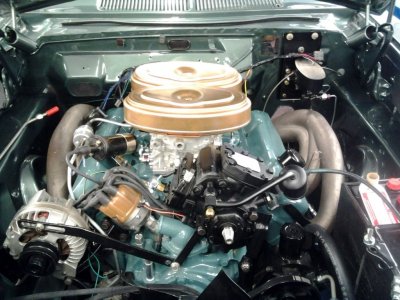

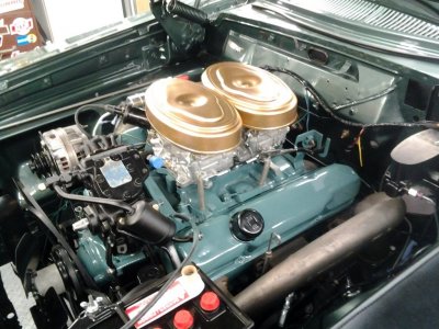

I have a 62 Dart with factory air that got converted to R134A. Contact CLASSIC AUTO AIR 5133 W. IDLEWILD AVE. TAMPA, FL 33634. They have everything that you will need and full instructions that are easy to follow. Here are a couple of pictures of my set up.

Contact CLASSIC AUTO AIR 5133 W. IDLEWILD AVE. TAMPA, FL 33634. They have everything you need to convert your original system to R134A. Here are a couple of pictures of my car with factory air. Works great
