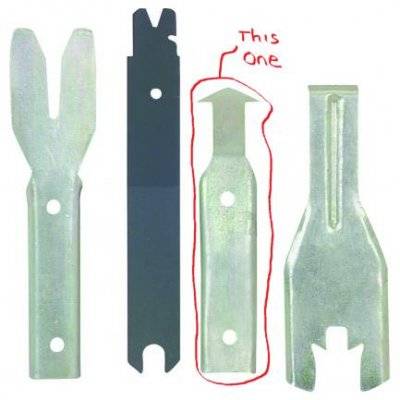

There is probably a better one out there but you can pick this up at pretty much any parts store
I don't know that there is a perfect tool for it.
The one pictured, I've tried and think a little grinding would help it.
I've fabricated my own "hooks" with putty knives that work good but have a short lifespan.

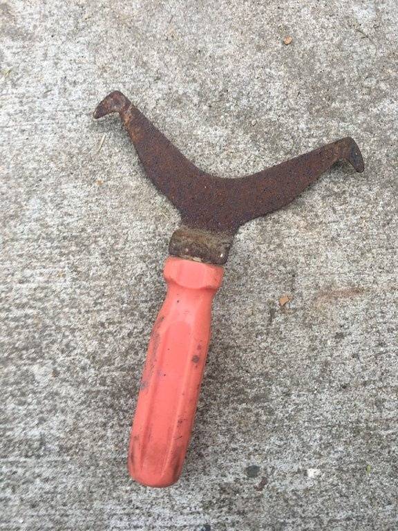

Here's the one that was recommended to me for my 67 belvedere . . . and it worked great . . .
thanks guys, conv67bdere do you know where i can buy one ? onlyone you have officialy scared me...lol
