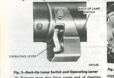

Ok, I have all wiring issues in and out solved. Except the reverse lights. Removed the plug and used a jumper and reverse lights come on. Removed the switch and then looked at the Service manual and it shows an "operating lever" on the steering column that would push the red spring loaded button on the back of the switch to complete the circuit and make the lights come on. No operating lever on my steering column. I'm betting it was made of plastic and hence broke years ago. I am definitely not feeling removing the column or whatever it will take to replace the operating lever. Other than using a toggle to turn on back up lights, does anyone have any suggestions?

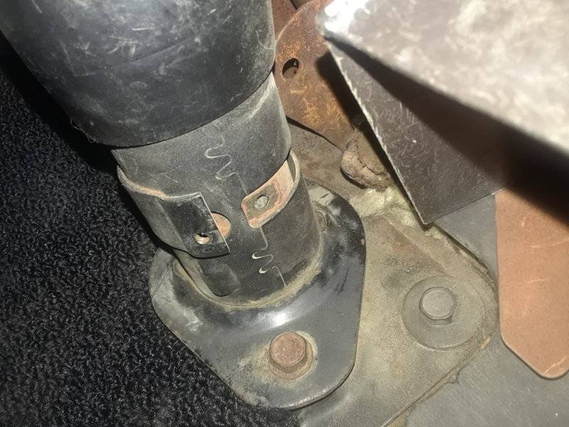

My mechanical engineer colleague put the selector on drive and crawled under to look at the hole for the actuator. He felt it should be tapped, but even he could not get an idea on screw length.
Picture attached of the hole with selector in drive.
Second picture hole diameter.

Thanks. I measure from the base of the actual switch to the top of the cover that curves over the red lever. Its about 7/8". I think I'm gonna get a 1 inch self tapping machine screw. As close to the diameter as you show and tap it in. Check length and cut head off. If its good, it only needs to be in a couple threads with red locktight and a locknut. As long as it doesn't interfere with the shifter going from P-1, all good and the thin lock nut should help keep it from trying to bend from side to side with the spring tension always on it.
It looks like a #10 machine screw is closest at 0.19 inch diameter.

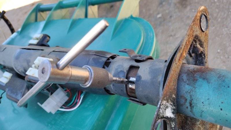

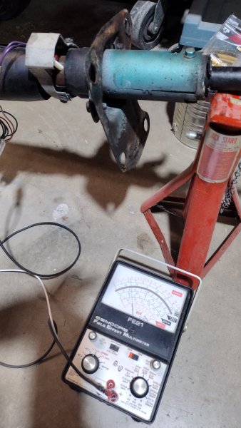

Steering column is out for a coupler rebuild while the steering box is at Steer N Gear.

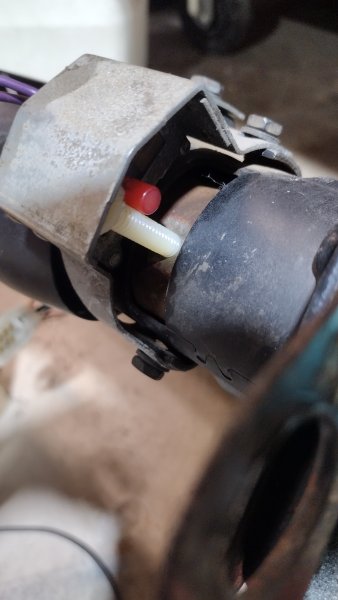

Went around the neighborhood in search of a Tap with a flat bottom. One neighbor had a 1/4 20 Tap. I could get about three threads tapped. Tried a screw and it did thread in properly.

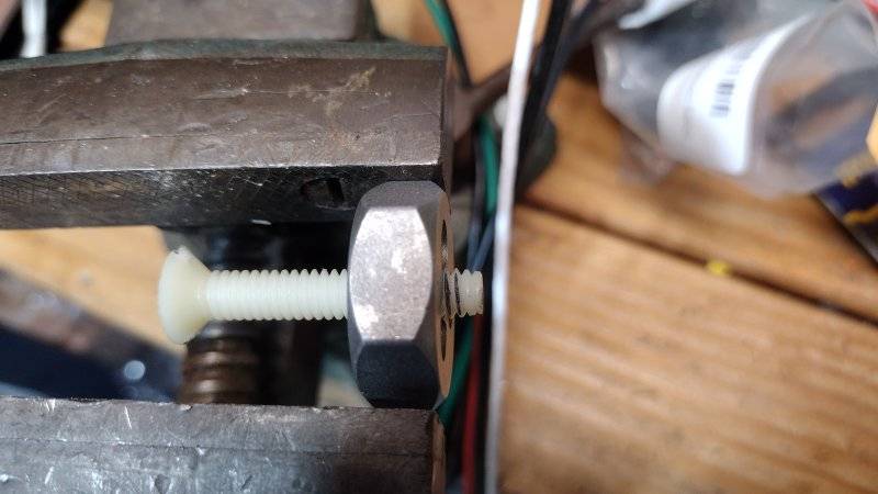

Plan to get a nylon screw to see if this will work.

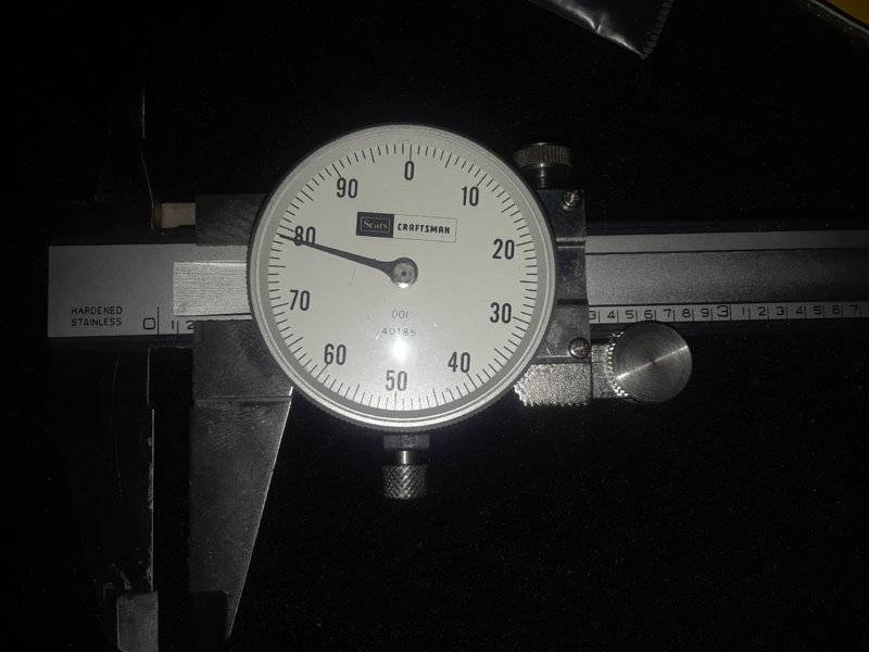

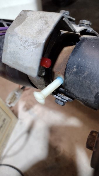

I got a 1/4 20 1.5 inch long flat head nylon screw. Made a few measurements with my calipers. Looks like I need 1.35 inches for the perfect fit. Cut the screw down and cleaned the threads with a die. Reassembled and per my ohm meter looks like this will work. Sprayed some CRC silicone lube into the switch and coated the screw. Time will tell if this is a good fix.
Just for good measure I placed some blue loctite on the threads. Wish me luck here.
