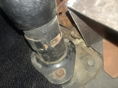

My mechanical engineer colleague put the selector on drive and crawled under to look at the hole for the actuator. He felt it should be tapped, but even he could not get an idea on screw length.
Picture attached of the hole with selector in drive.

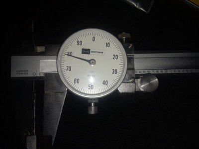

Second picture hole diameter.
Thanks. I measure from the base of the actual switch to the top of the cover that curves over the red lever. Its about 7/8". I think I'm gonna get a 1 inch self tapping machine screw. As close to the diameter as you show and tap it in. Check length and cut head off. If its good, it only needs to be in a couple threads with red locktight and a locknut. As long as it doesn't interfere with the shifter going from P-1, all good and the thin lock nut should help keep it from trying to bend from side to side with the spring tension always on it.
