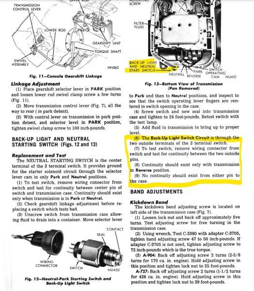

In addition to checking the shift linkage, take a look at the wiring to the switch and test the two outside wires in each position to hunt down what sounds like an inadvertent ground. you can have a bad switch (even new ones can arrive broken) or in messy scenarios the shifter linkage inside the transmission is out of adjustment.
For testing, check out this short vid... the guy does a very good job explaining the what's and why's and how to test.
