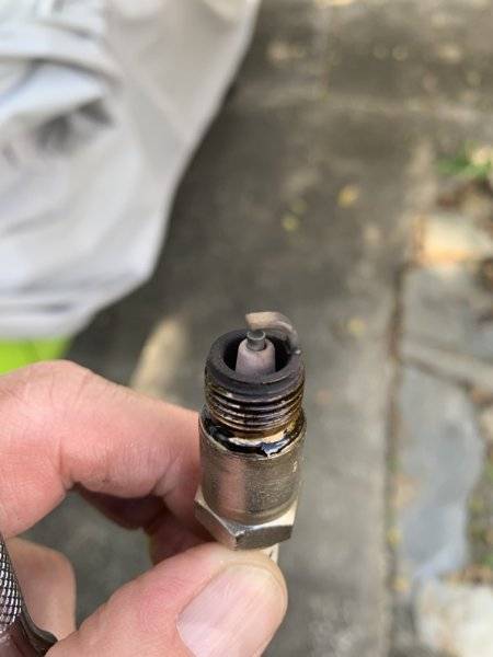

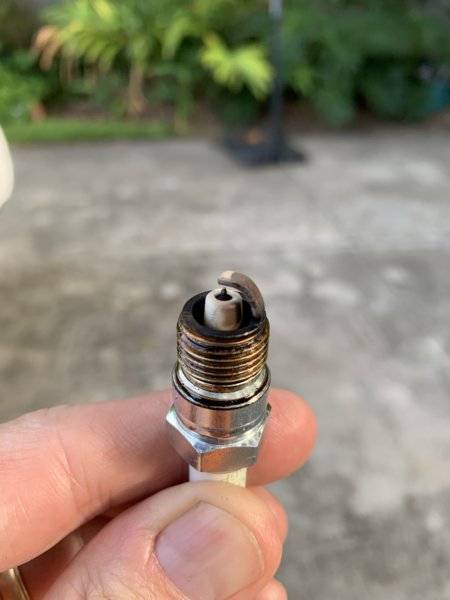

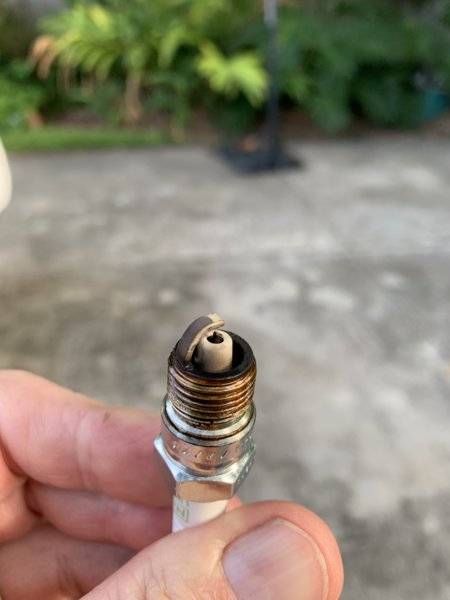

On Friday I replaced the 68 primary jets with 71s because the plugs were so white I was worried it was too lean on cruise. Here are the plugs this morning...much nicer shade of tan. My afr with these jets at light throttle cruise is 12.5-13.4. What do you think of that timing strap mark? Note when the plugs were white, that heat mark on the strap was in the middle of the curve.
I live in a big city and long country roads are not close by so I can’t do long wot runs with immediate shut downs to check plug color unfortunately.
These are the plugs I’m using.
Normally that location of timing strap mark is the idle mark, the WOT timing strap mark supposed to be at the middle of the curve.
But as you mentioned it is hard to test WOT in your area.
At light cruise people say going in to 15's AFR is also ok, just makes a clean/lean burn and low consumption on long stretches of road.
I think your primary is set where it should be, just need to get the secondary's to work and see what readings you get.
Then adjustments can be done to get the afr readings good at high load and WOT.

Out of curiosity, the plug you show in your pixes APPEARS to be, in the first set of pixs, to be a platinum/irridium extended tip plug and the last pix shows a conventional (non ) platinum/irridium electrode design. In NGKs heat range chart, heat range 5 is a relatively hot plug, which would show a white(r) coloration. Should you consider a slightest colder range of 6 or possibly 7?? The ground electrode (aka "strap") does show the correct coloration, but the shell shows a rich condition. USUALLY, the premium plugs have an improved ground electrode construction allowing better heat dissipation characteristics and as a result, color differently. Also NGKs offer a "V" shaped ground electrode claimed to provide a better flame kernel development and better fuel charge ignitability...better for lean mixture operation.
BOB RENTON

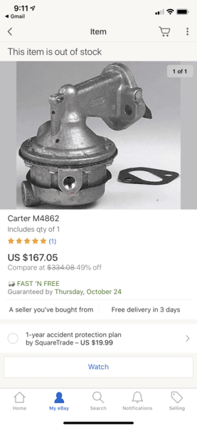

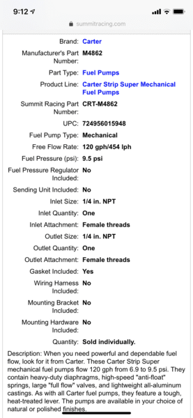

I think I’ve finally solved the issue. I installed a Carter m4862 (9psi) fuel pump and Holley fuel regulator back in may thinking I could help the fuel boiling issue by recirculating the extra fuel. This pump is for 6 packs and double carburetors. I have a 1/4” return line but the regulator requires at least a 5/16 which I ignored. While in park if I rev the engine over 3,000 rpm the fuel gauge reads over 8 psi as the regulator can’t relieve the pressure through the small line fast enough. I’ve tried 3 different carburetors all with the exact condition (Air fuel ratio in the 9s wot).
I ordered the stock Edelbrock 6.5 psi carb and will report back. Anyone needs a carter hp fuel pump with 1000 miles on it hit me up. Paid $167 for it new at summit.
View attachment 852903 View attachment 852904 I think I’ve finally solved the issue. I installed a Carter m4862 (9psi) fuel pump and Holley fuel regulator back in may thinking I could help the fuel boiling issue by recirculating the extra fuel. This pump is for 6 packs and double carburetors. I have a 1/4” return line but the regulator requires at least a 5/16 which I ignored. While in park if I rev the engine over 3,000 rpm the fuel gauge reads over 8 psi as the regulator can’t relieve the pressure through the small line fast enough. I’ve tried 3 different carburetors all with the exact condition (Air fuel ratio in the 9s wot).
well so much for that theory. Installed the new pump and it’s dead on 6psi; however I still have the wot bog. I’ve tried a 650 eddy, 750 Holley, and now a 800 eddy and all 3 have the same issues: 1/2 throttle it’s awesome. Wot it chokes and surges and falls on its face and stays there. Air fuel gauge drops into the 9s (could be wrong but who knows). I went from super lean .092 secondary jets to .104. No change. Played with step up springs. Nothing. I can control idle and cruise fuel mixtures but nothing helps wot. Timing is with a MSD ready to run dizzy 18 initial 36 total with light blue and light springs. Vac advance hooked up. What am I missing? 1978 440, stock heads, raised pistons, comp cam specs attached. Newly rebuilt.
