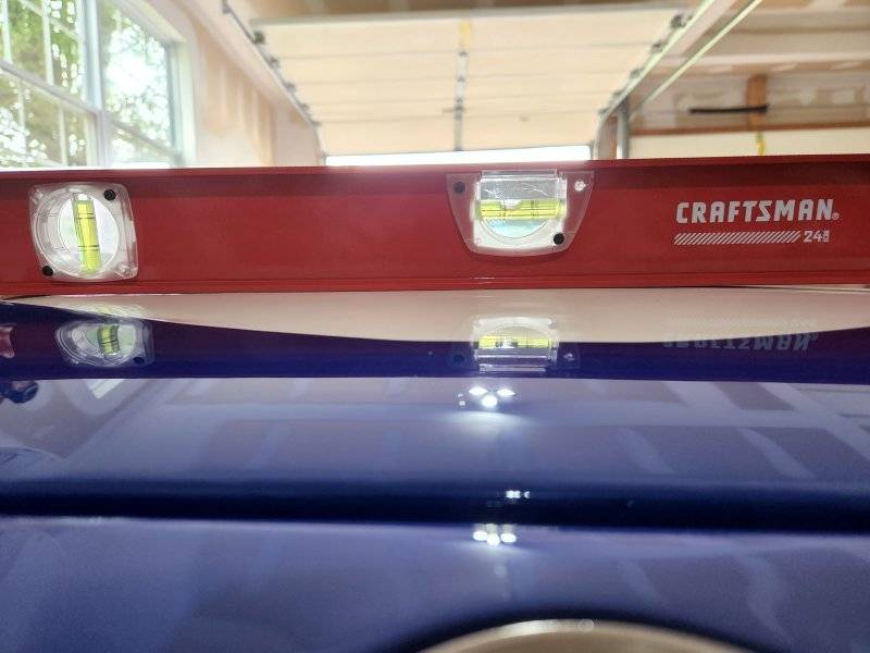

Left side of my 72 Satellite sits 1.5" lower in the front, and 1.375" lower in the rear. The garage floor is acceptable level-wise. The front end is basically stock K-frame/T-bar, while the rear is a 4-link with Viking Coil overs. The rear has the shocks set at the same height. I've not adjusted the front via the Torsion bars yet, as I wanted to get some advice before changing anything. Is it possible for the front to affect the rear by that much? Thanks in advance for any and all help.

Measurements from center wheel opening(s) to floor:
Front Left = 25.25"
Front Right = 26.75"
Rear Left = 26.375"
Rear Right = 27.75"
