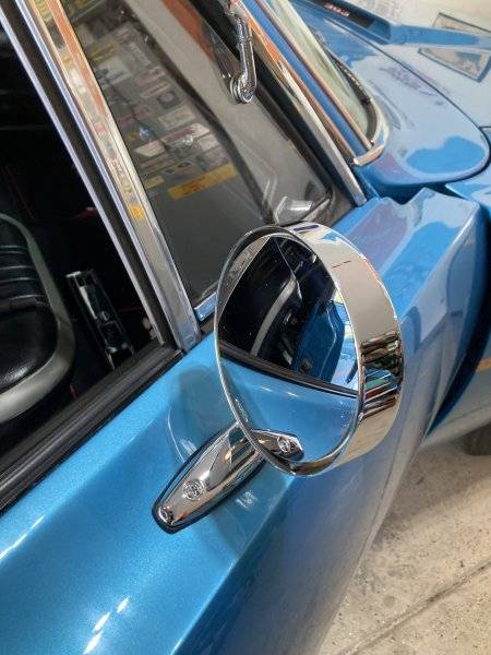

Fatties-Round Mirror Replacement Glass 4-3/8"
Fatties round CONVEX mirror glass can be used as a replacement for your flat glass. Glue over top or break out the old and install with RTV Silicone Adhesive. Sold Individually.

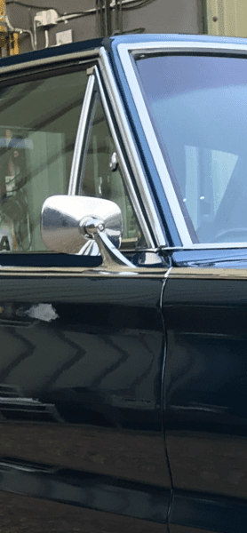

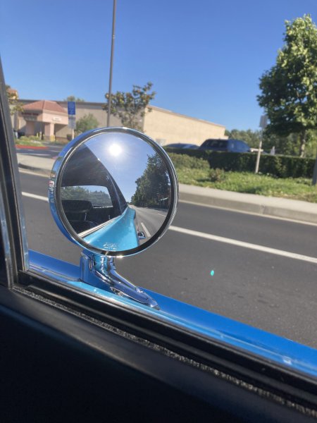

Don’t want to resurrect a thread but thanks for the awesome idea! I love driving on weekends and new car drivers are nuts and don’t realize about blind spots! No matter how many times I’d check by turning around, someone would zip in right next to me at merges. So I took your idea, measured and added a right hand mirror and got the convex mirror you mention above. I just glued it on with rtv adhesive. Is it perfect looking? Eh, maybe, but what a difference! I tried just the stock mirror and it was almost pointless. But that convex mirror makes it like a modern car and much more safe in traffic.

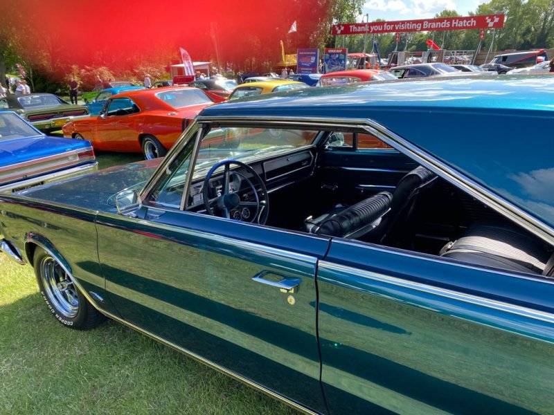

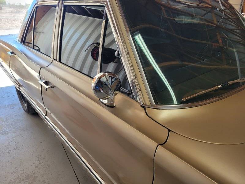

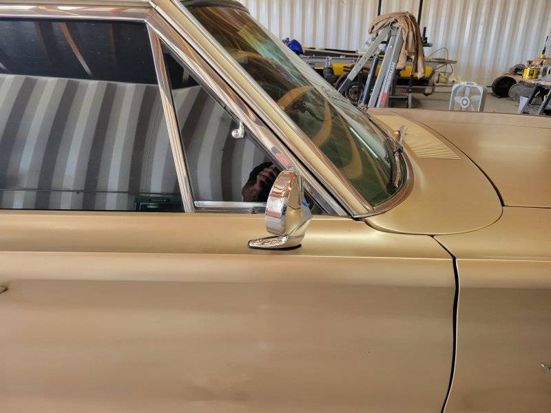

On b-bodies The 1968-1970 RH mirror was mounted behind the wing frame making it impossible to see down the side of the car.
1966-1967 they were forward and you look through the wing window at the mirror and you can see down the side of the car, much better.
Good point! I had a 67 4 door dart as a beater in the 80s and I remember the mirror being forward of the vent window, almost to the fender. But when a passenger would crack the window to let smoke out (every girl I dated smoked back then), I remember thinking it was obstructing my mirror. Maybe that's why they moved it.
I sat in the driver’s seat of our Charger and moved the passenger mirror with tape until I could use it well. Then I could get the best advantage of the mirror. This is the one of the few cosmetic changes I have done to the car.
Sometime during the 68-70 production both mirrors moved back a considerable distance, while keeping the same relative distance on each side from the leading edge of the door.
This causes the driver to turn their head quite a bit more, in order to see the mirrors.
...and if you can see the side of the car in the passenger mirror, you can not see the blind spot, which IMO is surely the intent of the mirror on that side in the first place.
So is it domed? Would you add one to both mirrors?
Happy to help.
Yes it is domed. I personally would keep the driver’s side normal.
That’s what I did. Left the drivers side alone and put the convex on the passenger mirror. Took it for a drive today in decent traffic for over an hour and it was really a huge difference.
