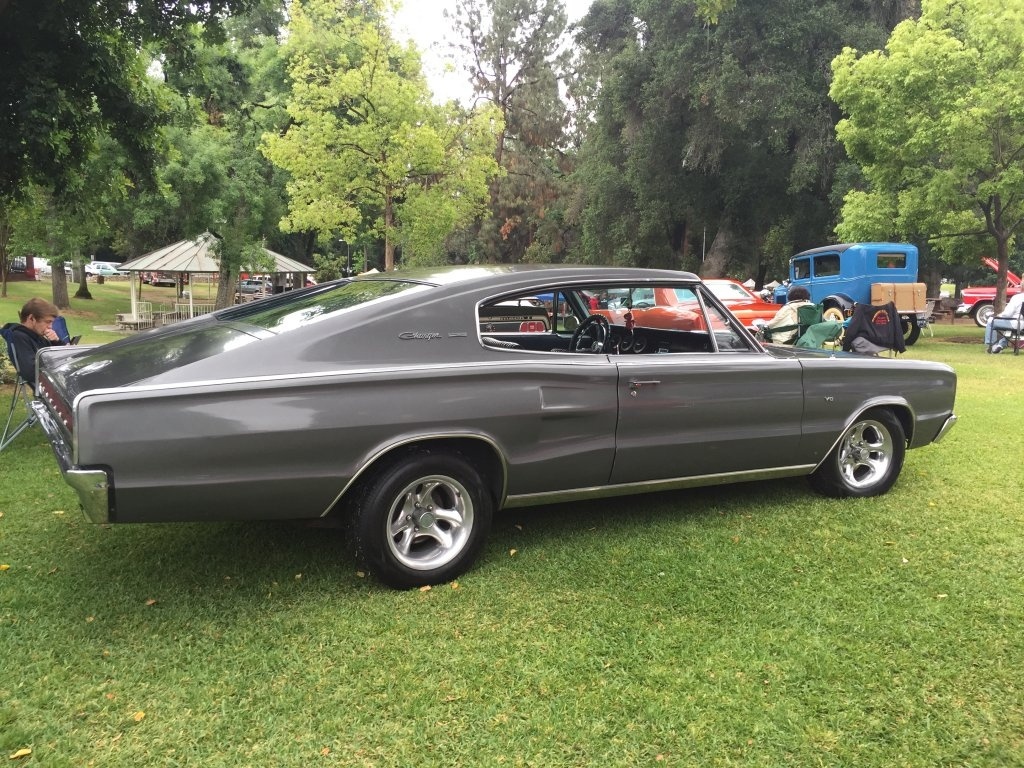

I am looking for opinions on new rims and tires for my 66 Charger. Stance is what I guess you call it. I want to go with traditional rims American Racing , Craiger etc. I would like to do the wide in the rear narrow ish in the front , but wanting to fill in that big wheel well space this style of car presents.
What say you all, want to do this right the first time, big investment.
Thanks
RELAM
If you are sticking with a 15 inch rim diameter then a 275-60-15 will tuck nicely into the rear of this car with the correct offset rim. The 28 inch diameter fills the space well and is plenty wide. Some guys have used the 295-50-15 which is wider still but much shorter. For the front, anything with a 26 inch or slightly taller size will look good, you can use a 75,70, 65 or 60 series to get the width and sidewall height for the look you are after.

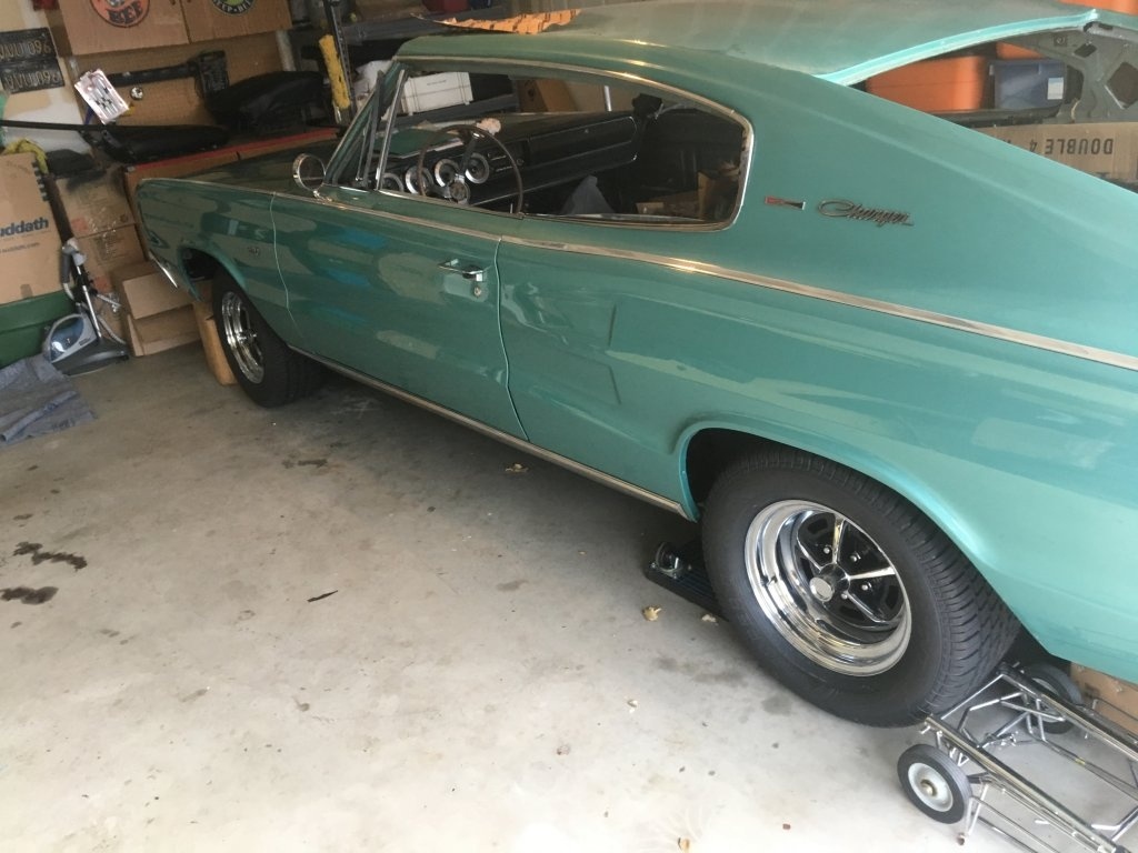

Vintage 15" Slots would look nice
Great info Greg I will use that for sure TY !
Ok I will see what the Slots look like and options.
