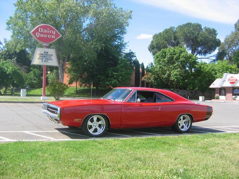

good points.
in my case my headers and oil pan didn't fit the stock.
Nice car too man

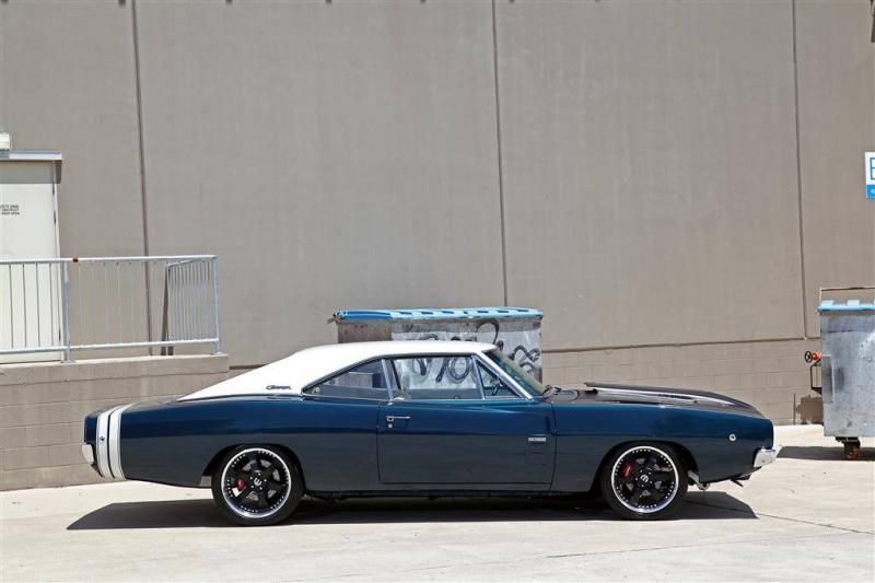

heres mine.

Nice car, Benno. That is a great look.
