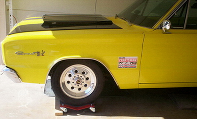

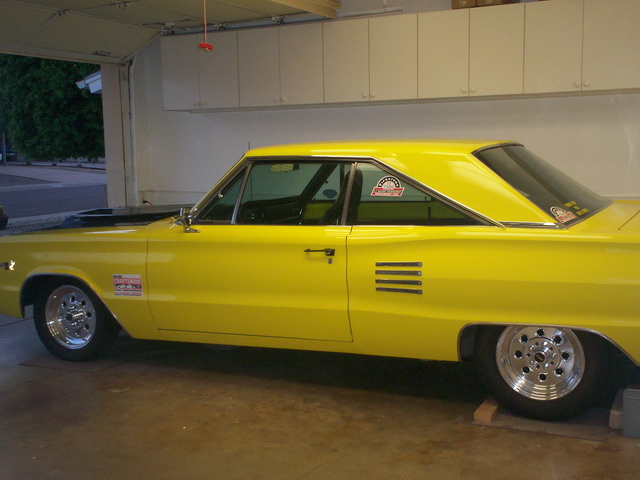

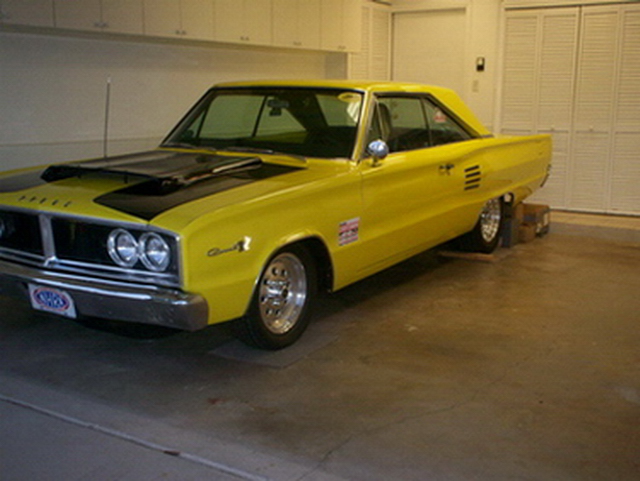

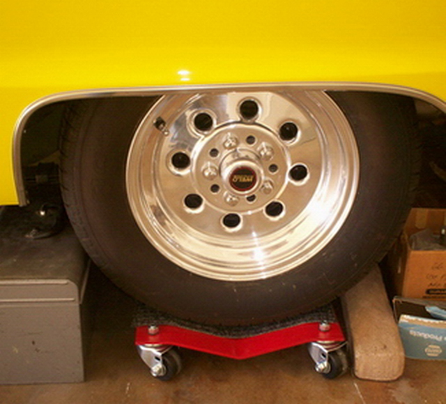

The American Racing Champ 500 wheels that are shown in the pictures above during it's restoration back in 1990 were 15 x 7 on all four corners, but I don't remember what the back spacing was.
The Weld Draglight wheels are part #90-57348 and are 15 x 7 on the rear with a 4 1/2" back space and the front's are part #90-54342 and are 15 x 4 with a 2 1/4" back space.
Jegs has the rears under their part #927-90-57348 for $209.99 each
front's are Jegs part #927-90-54342 with a list price of $195.99 each.
http://www.jegs.com/p/Weld+Racing/746346/10002/-1
When I was drag racing the car, I ran Mickey Thompson 26x10.5 x15 Sportsman Pro drag radials's on the rear and Mickey Thompson 26x7.5 x15 Sportsman Front Runners on the front.
Now that the car will be back on the street, I'm running B.F.G. P235-60R-15 Radial T/A's on the back and B.F.G. P185-60R-15 Traction T/A's on the front.
The pictures of the car without the race decals are with the B.F.G. street tires and the two pictures with the decals are with the Mickey Thompson drag tires.

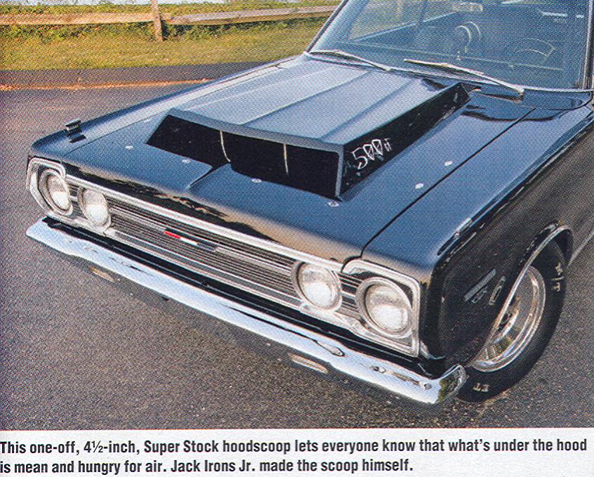

In conversations with former Ramchargers driver and NHRA record holder and race engine engineer Mike Buckel we have talked a bit about hood scoops. They did proving in wind tunnel tests that the 1st gen hood scoops like mine:
did absolutely S.F.A. Only helped give the car the race look. The R023 was better but still not really effective. The only ones that they saw any real results was the scoop off the Hurst Hemi Darts and Barracudas. They found the best induction was a cowl induction like in NASCAR application and that is why NASCAR uses it to this day. Now there are other manufacturers that make the original style hood scoops with increased heights that make them work better. I have seen my style with a 7" height, you would start to get more of a look like this:
So from this, do you want it to work (68 Hurst Hemi's) or do you want it to look cool and period correct.

good info, beautiful car and cool graphic rendering. My first choice is period correct. Performance counts of course, I may modify mine to grab a little more air. I have a picture of a modded one in a magazine, I will dig it up and post it. I will check out Racer Brown's site. BTW, who did the graphic of the Polara, its very cool...
