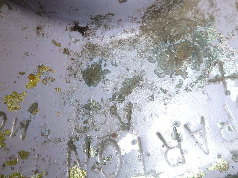

Why not just look at the date stamping on the horn.

Yes I did watch it and it is informative but dates are the sure fire way of telling.For instance and I'm not 100% sure but I believe there was a short arm non threaded horn used on 1969 22" core radiator cars long arm on 26" cores. I think it would be great if some owners would check the dates

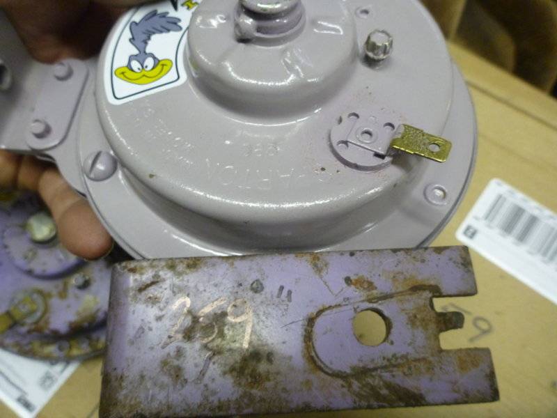

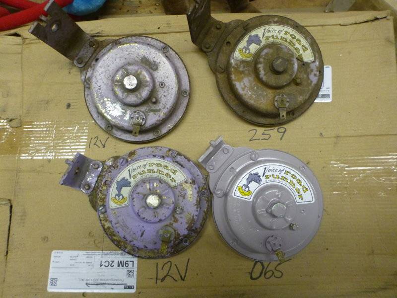

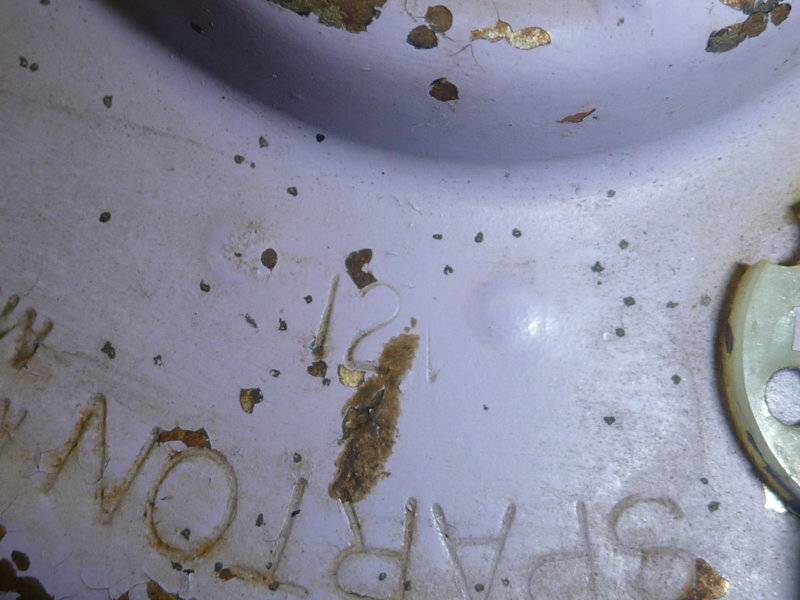

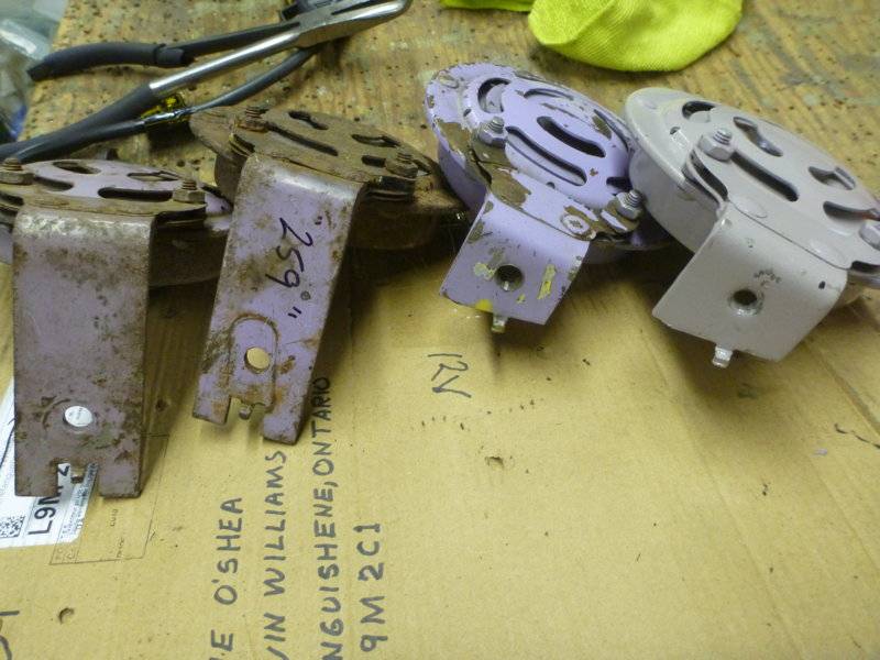

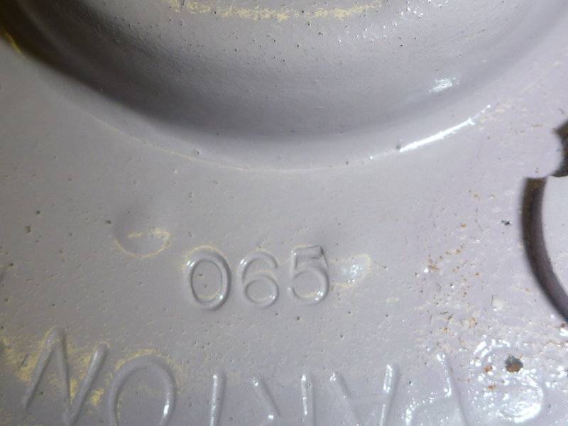

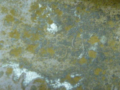

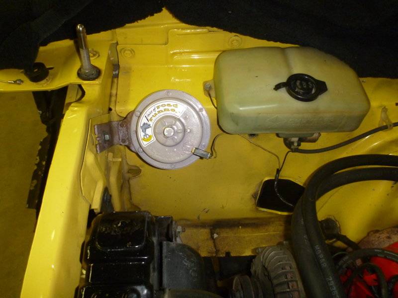

Okay... I put on my "loops" and had a go at the numbers and have come to the conclusion that OE (Line installed horns) were given a date code. OEM replacements were stamped 12 V and no date code. I have "12V" on both the short arm horn I took off the car and on one of the long arm horns I picked up to restore. On the other long arm horn it is stamped 259 (25th week of '69) so I guess this is my restoration project for another day. On the "NOS" horn that I bought with the short arm, I am highly suspect someone found a batch of Jeep horns, repainted them and slapped stickers on them. Date code is "065", which I believe is 6th week of 1965.. maybe '75? Playing with the adjuster bolt did very little if anything to change the sound, still sounds like an episode of MASH.. but I swapped on the best long arm and it's in the car. Colour seems a TAD off as well! Unfortunately, it's all I have time for in the panic to get her ready to go to Dega so it's on the car....

Chrysler had Sparton build them with a different tone for the Birds. The adjuster does little to change it, it's only an oscillation distance device when it comes right down to it and not really for tone.

The color and sound difference is "shocking" to say the least......
