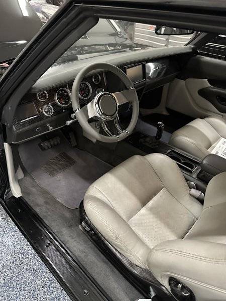

Hey there fellas. Finally got my dream car (pics below). I’m wanting to swap out the steering wheel to something more fitting to the interior. Having a hard time finding a straight answer.
But.. 69 Roadrunner, tilt column. Are they the same spline count / size as a GM column when it comes to the steering wheel adapter? I’m wanting a Sparc wheel for it but the only options are GM essentially.

I doubt anyone here will be much help - the only thing I see in the interior pic that might be original is the rear-view mirror?
If even Chrysler, ...maybe the column is from C-body or Imperial?
Good luck. It's the nature of the beast with resto-mods.

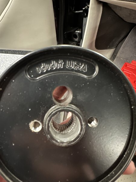

Ok I think I got it, but can you guys check me / back me up here
The adapter is an ididit adapter for a 6 bolt momo.
The column more certainly isn’t an ididit (it’s just not refined enough). It was also $260 in 2012..
But since ididit only makes adapters for their own columns / 69+ GM, it should be safe to assume that this column is a 69+ sourced column, no?
