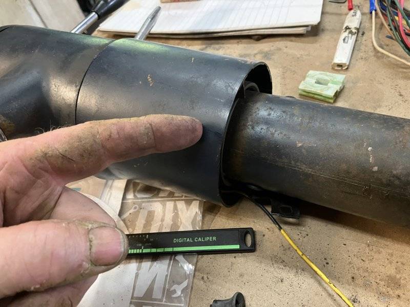

First, this column is longer than the stock one. I expected that to a smaller degree.
Measuring from the under dash mounts to the mounting face of the adapter….
That is about 15 5/8” to 3/4”. The one in the car…

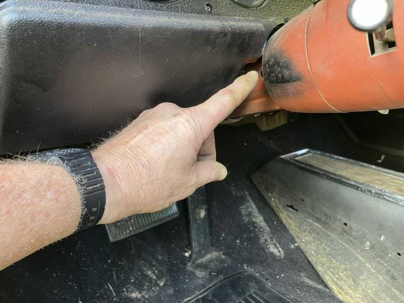

Forgive the angle. I measured 14 1/4”. That puts the steering wheel about 1 1/4” closer to my chest. I don’t think I’d like that. Where it is now is actually comfortable. If I can ever get my wife to learn to drive the manual transmission, her short legs would put her closer to the dash and her chest right up near the wheel.
No, she isn’t a midget. She is 5’ 1/2”.

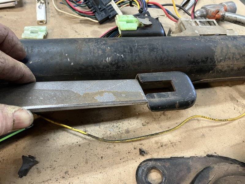

Now yeah… this is my car so I should make it fit me and maybe that 1 1/4” wouldn’t bother me. What if I could weld tabs right here?
This would allow me to move the whole column toward the firewall.
Uhhhh, not so fast. Looking at how it is right here:
…. There is about 6 5/16” from the middle of the mount to the face of the lower collar on the column.
The stock column is at 6 1/8” so that is close enough to make it work if I installed the column as it is. To push the column toward the firewall any, I’d have to cut this:

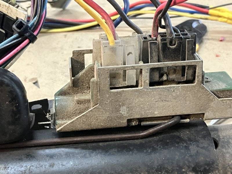

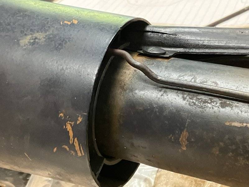

Not a deal breaker but there are other things in there to consider.
