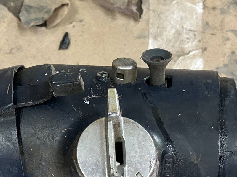

Unlike late model cars that only tilt from the firewall, old style tilt columns tilted above your thighs and are great for driving comfort as well as making it easier to enter and exit the car. This one would get cleaned and painted so don’t be bothered by the rough appearance.

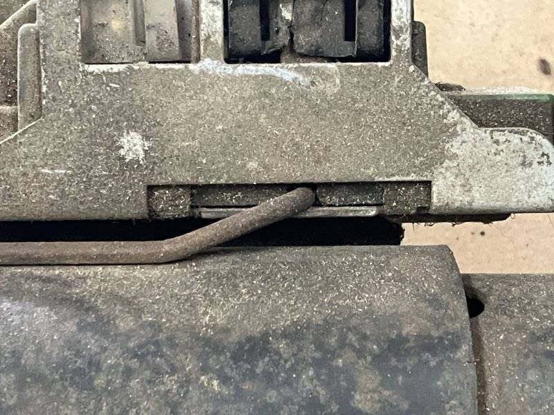

When the key is turned, a steel rod moves forward.

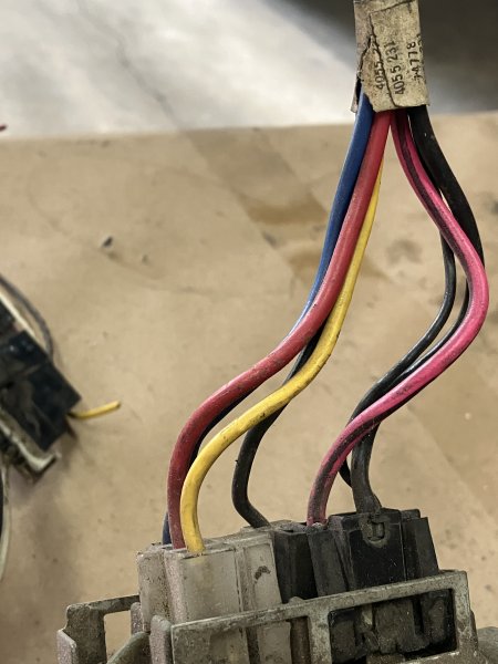

This moves a section in this unit on the left with the yellow, red, blue and other wires to it. Four of the wires are 12 gauge, the two others are 14.
This has me thinking that they are for the ignition switch.
The other wiring is smaller gauge.

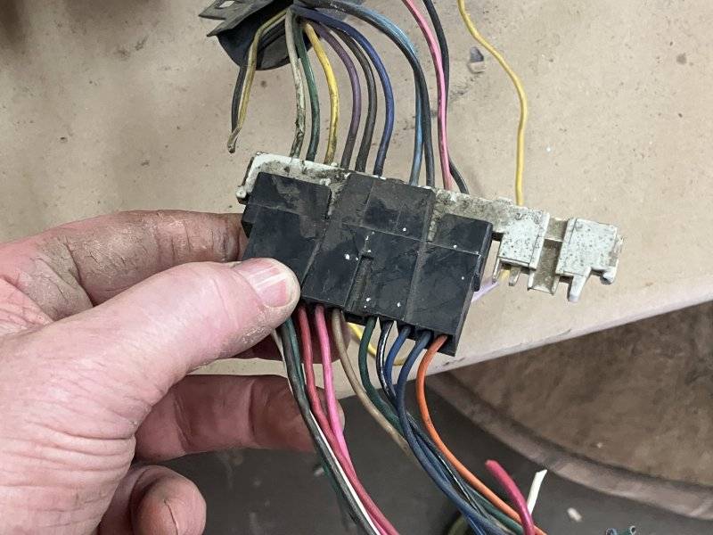

Chrysler used GMs Saginaw division for the tilt columns so they had a hybrid sort of harness as evident by the connectors not having matching color wires on each end. The smaller gauge harness is likely the turn signals, flasher, horn and cruise control!

That is most definitely the ignition switch on the column. Time to break out the ohmmeter and chase the wires. If you have the keys it will pretty easy. I would think the red wire will be the power to the switch so just start from there with the key in the run position to find continuity to the other wires. Then to the start position to find the start wire, and on to acc.
You will see that the switch has slotted holes for installation. If I remember correctly the switch had a witness hole where you could stick a pin to make sure the switch was in the correct position (OFF) to install it so the rod will be in the correct position.
They used those jumper harnesses to adapt the mopar wiring to the GM switches.

Maybe the 1975 models didn’t offer tilt wheel? The Saginaw column is mostly GM parts. This rod is at this position with the ignition switch locked.
Turning the key, it moved the rod rearward.

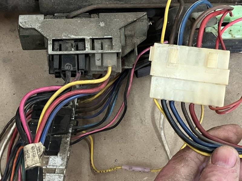

The plug coming off the switch:
There is no mention of a Pink 14 ga with black tracer in this manual.

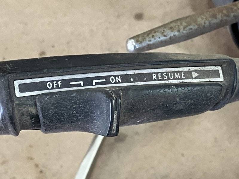

I did trace the wires for cruise control. Those won’t matter.

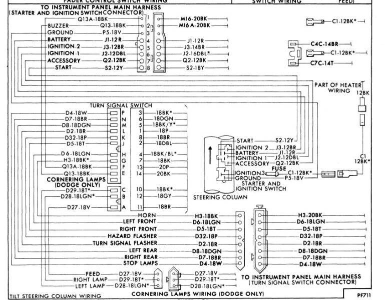

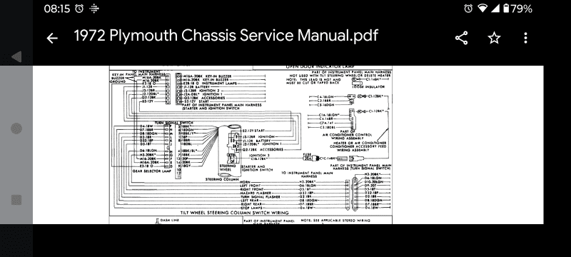

As I recall the FSM was not very good when it came to the tilt wiring. Its like all they covered was the standard mopar column. I also believe 75-77 was pretty close to the same and 78 and newer had some differences.
Here is a 73 wiring and it will be very close. You can use this to start sorting and tagging wires.

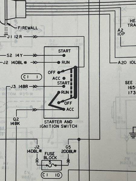

So if you hook your ohmmeter to the red wire and with the switch on you should have continuity with the 14ga DBL wire which is run. If you put the switch to start the 14ga Y and 14ga BR wire should have continuity for start to the start relay and ignition during start. It appears the 14ga BK wire has power through the switch during run and in acc position which will power everything that is powered off the switch.
So Pnora's diagram is the same wire colors just different sizes and shows the extra wires.
You need a service manual for your car and what the column came out of. The wiring diagrams should show you what wires need to go where.

The diagram I posted will get you close. There might be some color variations but the orientation should be correct. The FSM on a lot of car lines is lame when it comes to the GM saginaw column wiring with the jumpers. Sometimes looking in the c-bodies esp the high line models will have more information. They also have options that the b-bodies did not use so be careful not to go down that rabbit hole. You could get a replacement pigtail for the column and hard wire them to your car harness eliminating the jumpers. Not that much work once you understand what each wire does. Plus it will be a lot cleaner and neater.
You have everything you need to make it start and run, but you're going to have to have the full wiring diagram for the turn signals. You could splice the wires from your ignition switch right to the wires on the tilt column switch since you have the pigtail.
