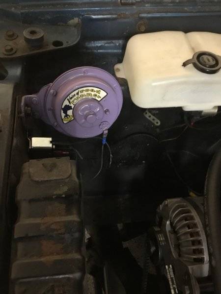

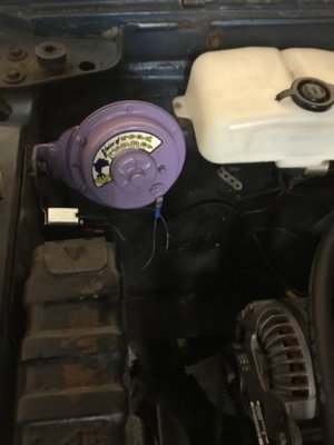

I have 69rr I bought off a friend he has a restored horn but it doesn’t make the roadrunner sound. It’s sounds honky and hallow. I changed the horn relay and sounds the same. I tried to tune it, it does nothing. Is the horn bad.
You may need to rebuild the horn..
Who rebuilt them.My friend can’t remember where he got it from.
Someone here had a good write up with quality pictures a few years ago...can't find it right now, but someone will post here shortly I hope.
Do they have a tuning screw on them? If so just try turning it one way or the other until you get the tone you want.
It's just an old jeep horn when it comes right down to it.

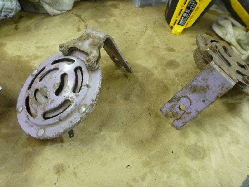

Could be your picture angle, but is that a short arm mount vs the correct long arm. I have the same issue on my Bird, someone back in the 80's put a '71 up short arm horn on after drilling out the threads to mount it to the rad bulkhead nut. 69 / 70 use a long arm mount, just wish I'd known that before I paid $$'s for a new NOS horn that matched what I had (and then questioned the threaded hole in the arm)! Have since obtained an inop long arm horn for the arm.
Yes it’s a short arm horn. It was restored twenty years ago. My friend never installed it in the car.
Then it's a '71 up horn with the threads drilled out so it can bolt on like 69/70's do to the radiator support welded in nut. '71's and up use a bolt through the mounting structure into the threads on the horn arm. This is the correct horn mounting arm for '69/70 AFAIK.
