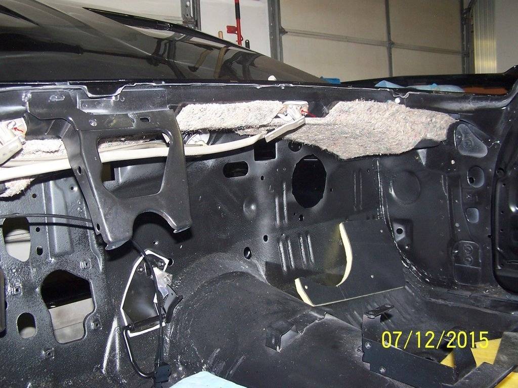

Has anyone installed the Shumacher wiper seal kit with the zerk fittings? I would like to install the zerk fittings but where is the best location for the fitting top or bottom of the pivot shaft. I don't have the car at my place to check, and see if there is anything in the way for zerk fitting access down the road. If anyone has some pics that would be great. This kit has the press in zerks.

It seems to me that if Shumacher created a kit with zerks, they should have sent some directions along. For me, it was not a question of how much the wipers would get used or if they would ever get greased again but mine were very dry and didn't turn at all. They needed grease and the only way I could think of was to add the zerk. IMO, it really don't matter whether the zerk is on the bottom, top, or center, as long as you can get some good grease in there.
Here is a pic of what I did.
