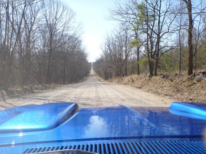

I just drive slow...

I try that but even still.... whack, plack, plink, whack, etc.
Dozens of trips so far and have yet to find a chip, even in my wheel wells that I've purposely left just painted...waiting for stone chip roughness to undercoat them. I have 1.5 miles of gravel to get to pavement every time I go in and out. Slow and a few "NASCAR" tire scrub swings after I hit pavement to throw the rock collection and then on it. BUT... I know the chips are coming sooner or later..
