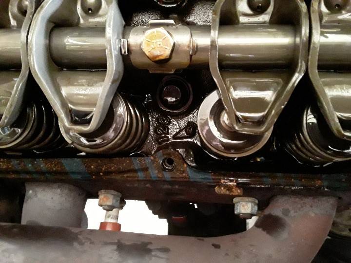

I have been struggling to get this motor to run right. First it wouldn't hold a time the timing mark jumped around on the balancer . So I changed the whole ignition system and it holds the timing mark great now but Still not running right. I hear a slight popping from number 2 cylinder so I pulled valve cover and see this. I am new to mopar engines but I would say the rockers should be centered on valve stem. Is there spacers or something that should be between these rockers? I am thinking this could possibly change cam lift and maybe even cause extra wear on guides by not being centered. Or am I overthinking this. Sorry for the long post but Like I said this is my first mopar and want it right. It is a 68 383 in my 65 Coronet

Your hold down washers might be swapped around or incorrect. Need a wide pic.

Ouch!! Any idea how it got together like that??
The missing spacers are an issue for sure....... but......that may or may not be the reason for the running problem.
Before I went too much further, I’d get the rockers set up with all the correct pieces, installed in all the right places...... and see if that solves the running problem.
Spacer ring between each pair of rockers...... hold down clamps arranged:
narrow/wide/narrow/wide/narrow
Long bolts used with the wide hold downs.
I’d be checking the lifter preload situation while I was in there tinkering.
I would guess the shop that did the work probably seen an easy mark. The old guy that had it wasn’t in good health and had it “ a little milder” according to his son. He didn’t drive it much after it was done. I drove it around late summer last year and put it up. Never ran as good as I thought it should but it ran ok and I didn’t try to run the crap out it. But I will get it fixed for sure. I am thinking they may have reused the lifters from the old cam that rocker is inconsistent in the movement up and down. I plan to bring a magnetic set of dial calipers home and check lift on all the rockers after the mopar swap meet in Indy this weekend.

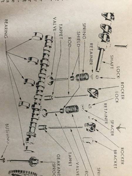

Be aware also....the rockers go in pairs of 'left' and 'right'. Once you have the spacers, install them Left-spacer-Right when looking toward the valves, from the middle of the engine. Look real close at a rocker you will see one edge is angled just a bit more than the other.

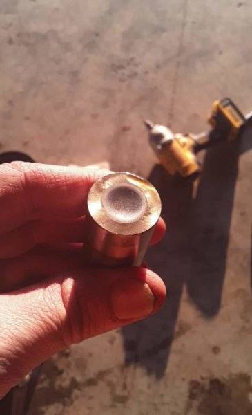

Well I got around to pulling the motor. Got it tore down. It has a lobe wore off the cam and lifter wore pretty bad. everything else looked good. So I plan on new bearings rings a new cam and lifter set. New oil pump just for precaution. Now to decide what cam to order. Thanks for all the advice on everything so far.
