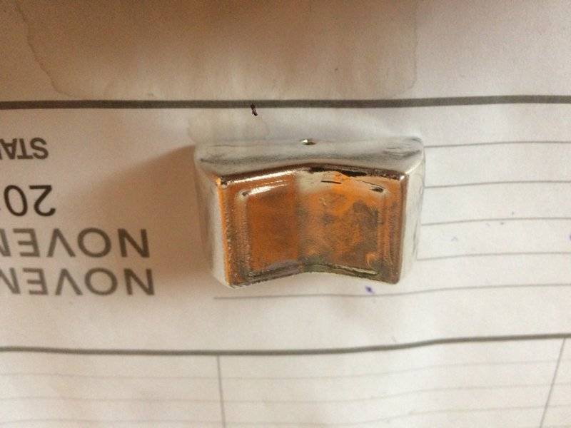

The biggest problem with re-chroming is the removal of the original "vacuum plating". If its left in place and refinished by any process there will be imperfections at all the edges of the original finish. If you can figure how to get that original finish off then you're away to the races ... find someone who does "spray chrome" and if the guy is any good at it they'll look like new.
On the other hand if he isn't any good at it and his display is full of great samples from the previous business owner it'll look like this ugly blob - which he had the balls to want $25 for !! (the orange tint is the reflection off the walls)
