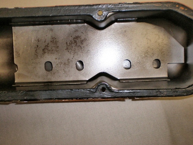

I'm using comp adjustable rockers with a comp cam with .500+ lift with stock big block valve covers, I have no interference. I'd try to weld the original back in a little higher even if you have to trim them slightly or fab some new ones. The Moroso universal baffles aren't big enough to work right.
Easy fix !
Not sure what was done here to fix. Can you explain? Did you re-weld the baffle, higher in the top of the valve cover? Thanks to all for the responses.
Didn't remove baffles,just cut clearance for adjusters.
