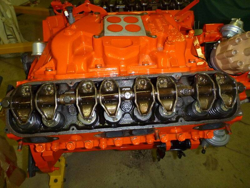

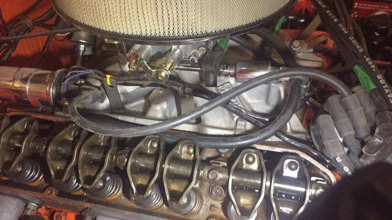

hi ihave a 383 my rockers are not aligned with the valve springs what would cause this
Do you have the left hand and right hand rockers in the right spots?
The rocker arms have a slight offset. They could be installed on the rocker shaft out of order, or even mixed up?
Hard to tell from the photo, but it looks like they are out of order / not paired correctly.
In the photo, the far right pair look swaped intake and exhaust. The bumps for the pushrods should be offset towards each other

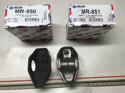

There is a right and a left rocker for each cylinder.
Other than the far right pair (that are swapped) you appear to be missing the spacer rings as well...

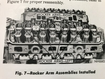

Here is a picture of what they are supposed to look like left & right.
Looks like you have a few backwards.
I found a 383 HP motor and they had half of them switched.

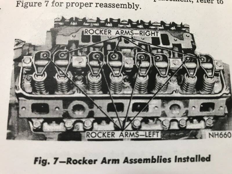

Question is what do they consider "left" and "right" as if that is a "pair" assembly would be wrong, if you put them where they call them...

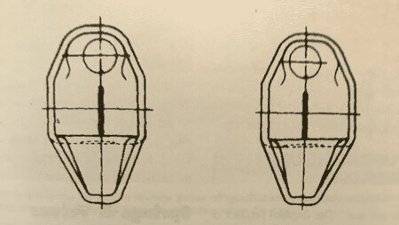

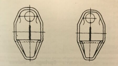

The drawing is incorrect.
It depicts the offset for the valve end of the rocker to be on the same side of the rocker as the pushrod offset...... which is clearly not how the actual rockers are.
The valve end offset is on the opposite side as the pushrod socket offset.
They install on the shafts so that the pushrod sockets are towards each other, and the valve end offsets are away from each other.

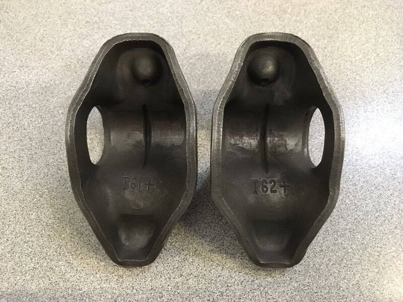

2B5AEDE2-9C7E-4626-8C7E-AF0370C5C7EF.png C1EB7B4B-67B7-4A2E-8855-3C6B7FDED272.jpeg

Well I'll be, the book is wrong! I got this from the HP Books "How to rebuild Big Block Mopar Engines" so that is a pretty big mistake for sure.

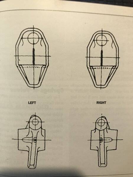

Here is a picture from my 69 Service manual that shows the setup and some rockers - left & right.
It looks like they are all bass ackwsrds and missing spacers.
For better input you could take a picture square on and folks here will let you know in a hurry what’s up.

I think you need to pull the rocker shaft off entirely and take a look at each one.
They might have some wear marks if they are run any length of time like that.
Inspect the valve tips as well...
Hopefully you can just fix the arrangement and everything will be cool

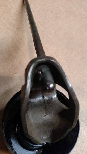

I would be very concerned about wear in the rocker pushrod socket
This is a known weakness for the factory rockers
High lift cams change the angle of wear inside the cup and produce a weakness that eventually cracks the socket
Placing those rockers in the wrong order has produced a new angle of wear inside the socket no different from changing to a high lift cam
Inspect them closely and dont hesitate to replace them
(for those that notice, this picture was taken many years after the failure and the rocker sat under a work bench for years. That's why it appears so rough)
