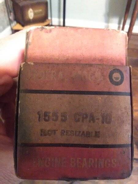

Found these in dad's garage anyone know what they fit ?
put two halves together and measure the id
and the width

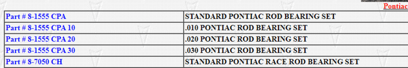

Actually, 2.2487" to 2.2497" rod journal
Max wall 0.0619"
Brng OD or Housing Bore 2.3745" to 2.3750"
Width 0.886"
Before Hemi Hots Heads started selling rod/main bearings (King Bearings), it was common to use a Pontiac 400 rod bearing. Bearings for the early hemi's were getting harder and harder to get, so this was a "get me by" solution.
