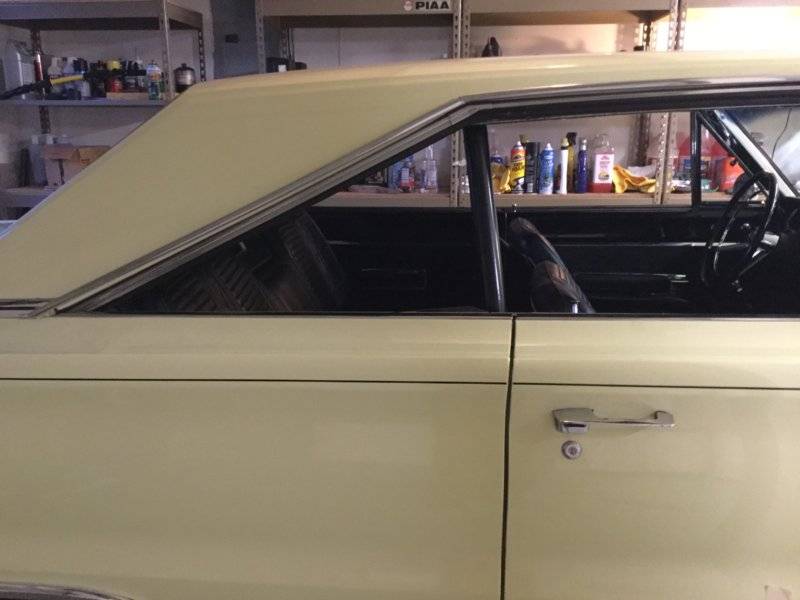

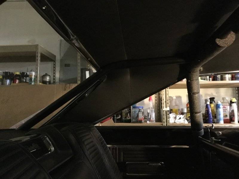

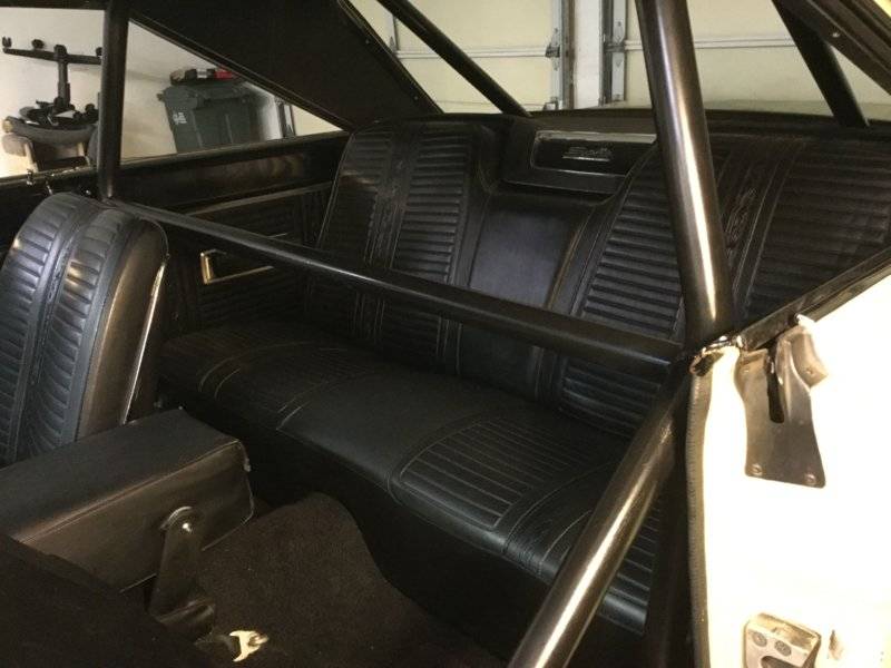

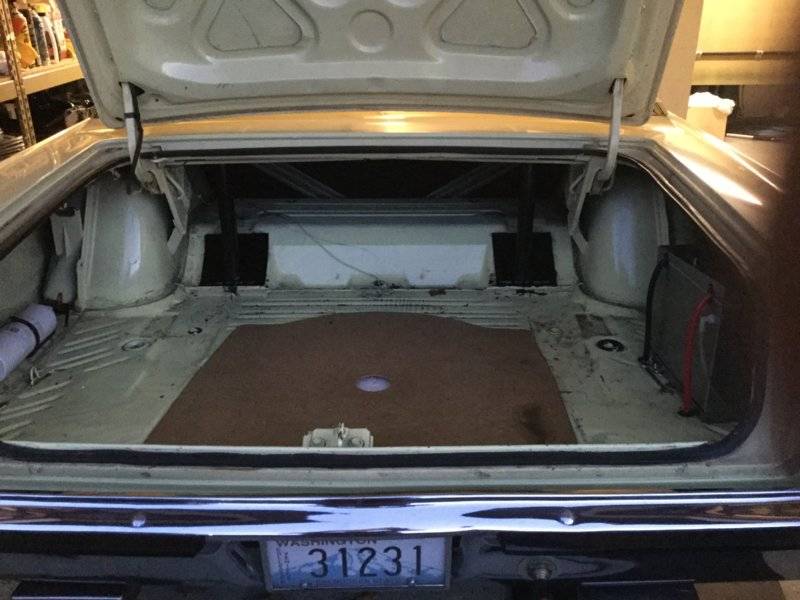

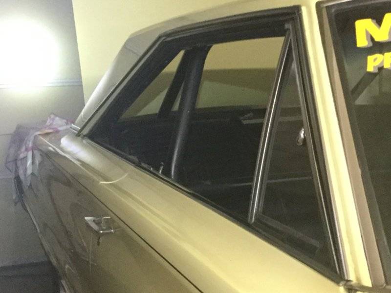

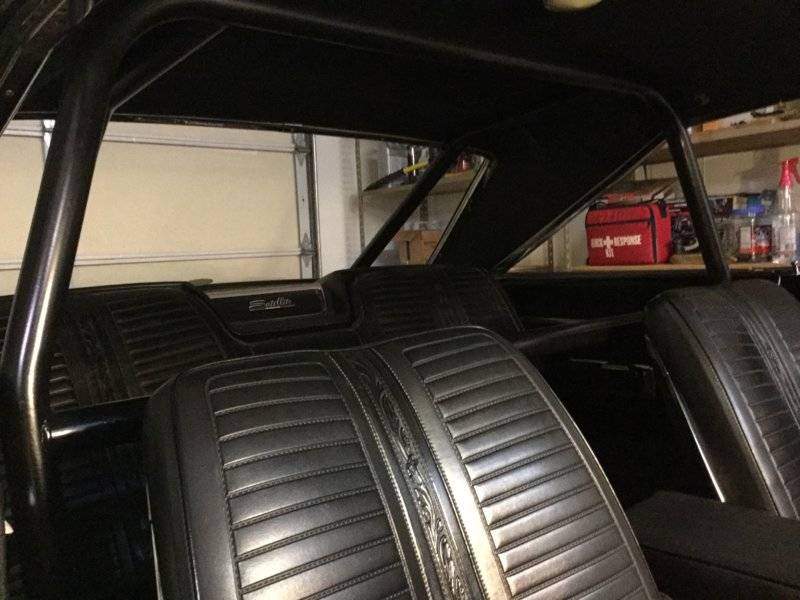

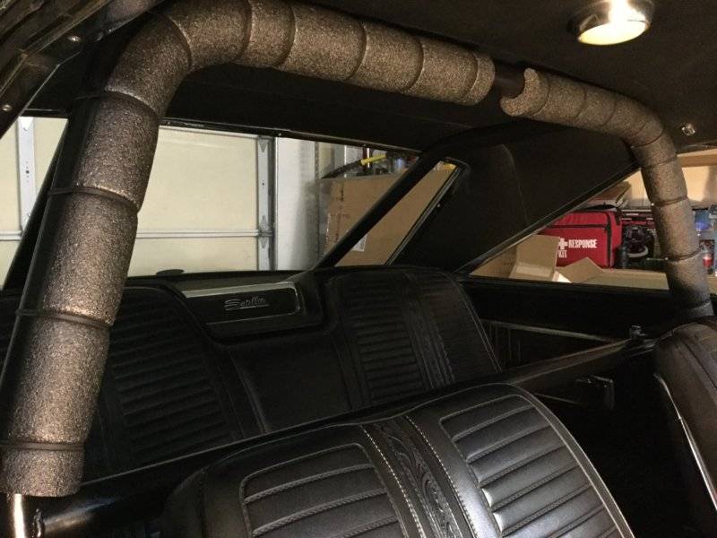

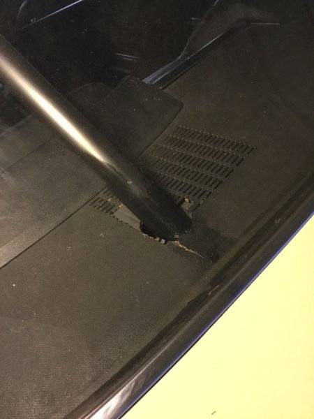

Sorry I haven’t been posting updates here, but progress has been being made and today I finished this project up. I believe this was the biggest project I’ve ever taken on with this car. To me it outweighs the engine, transmission, or rear end, all of which were built by me. All in all, I’m real happy with the way it turned out. The original package tray got f’d up a little. But I’m not to bent up about it. New package trays are only $50. What I’m real happy with is how well the bar fits the car. It’s tucked up about as tight as possible. Which actually created some problems. It’s about 1-1/2” from the rear glass. It got scratched getting installed through the package tray, and I can’t get to the back of the bars to properly touch them up, so the finish at the back sides of the rear bars looks a little hack right now; and it’s right there in sight through the back window. Oh well. If it really bugs me I’ll have to pull the rear glass someday. The rest of the bar is snug to the headliner, the angle of the main hoop follows the window seam angle perfectly, and the door bar turned out real good. It’s a breeze to get in and out of.
Now I can turn my focus to under the hood and getting the top end put back together.

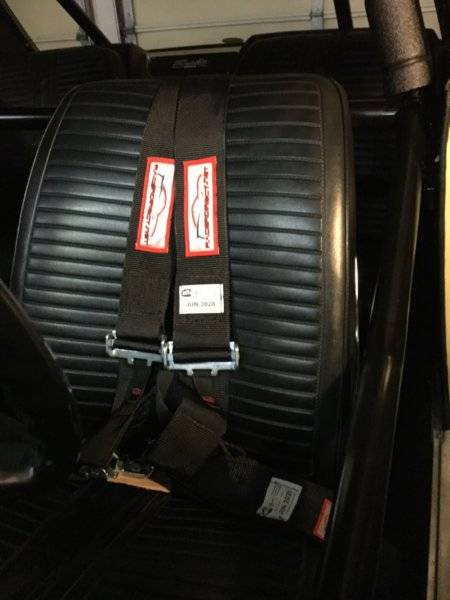

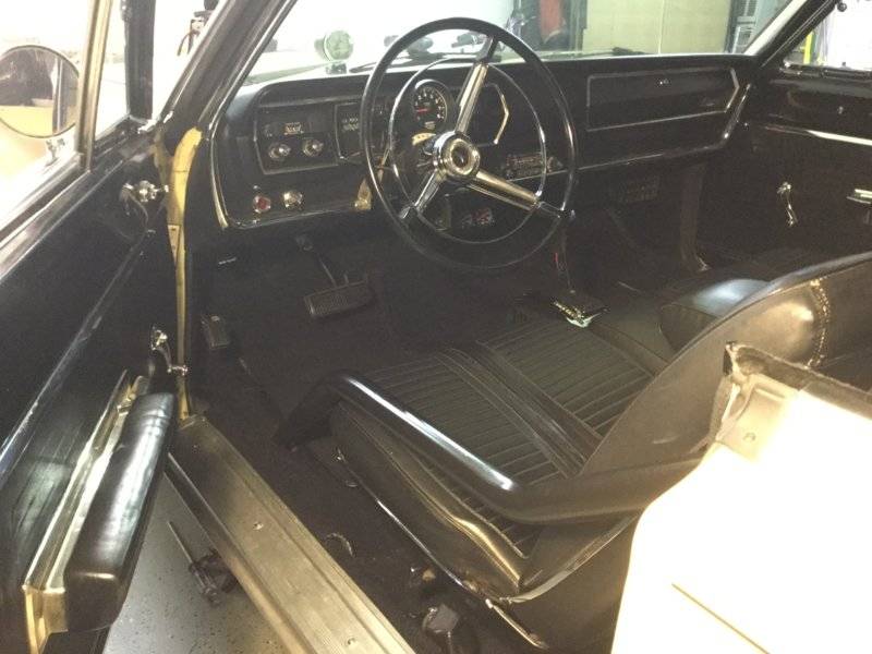

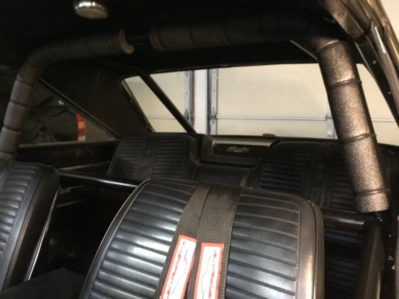

Finally completely done. Harness is in & padding is on. I think this project is complete. The only thing left is to figure out what I’m going to do with the rear window crank handles. The knob hits the bar. I guess I just need to take the knobs off, as the arm will pass by. A little bummed out to take those apart, but small potato’s I guess.

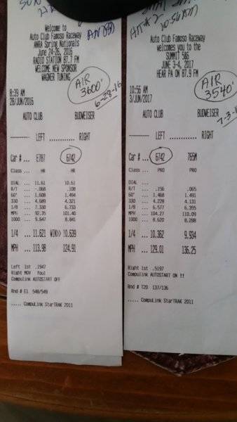

In regards to head porting....my local machine shop fella is a WIZ at port work.
He brought out my INDY standard port SEZ heads to MAX WEDGE size and then ported them to about 345cfm. He cleaned up my INDY Single Plane Dominator Intake also and port matched to the heads.
With NO OTHER CHANGES I picked up almost 3/10 of a second.
Went from 10.639 to 10.362
Same track and same adjusted altitude.

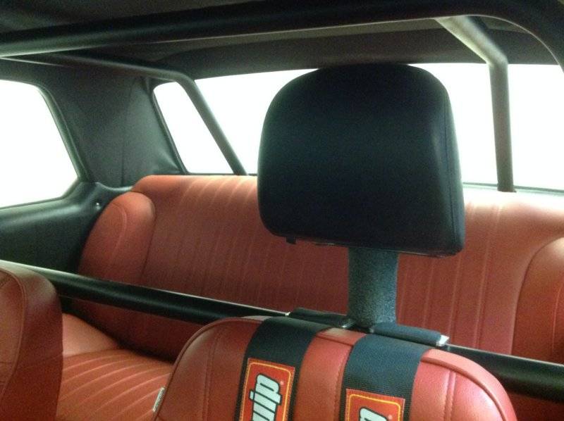

LW I have my headrest bolted to the same spot that your belts are secured. Easy addition.

LW I have one pic here, my car is up on the hoist tonight, will grab you a couple of close ups tomorrow.
I pulled the headrest out of something over at the auto wreckers. Cleaned and fab'd it into place. Unbolts with the belt bracket.

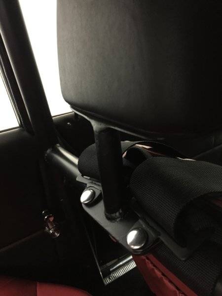

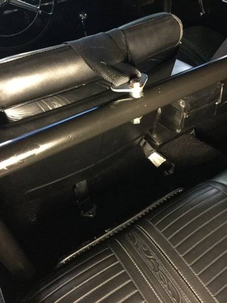

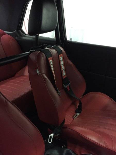

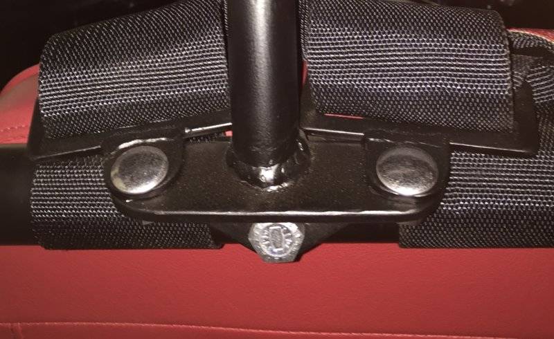

I had a look at mine today too, and I remember that my original plan was to secure my shoulder belts the same as you. I changed that. I wrapped my belts around the cross bar instead and then attached my head rest to the main bar. Some pictures.
The black belt brackets keep the belts from sliding on the cross bar.
Belts wrap around the cross bar and secured with proper belt hardware. I found that when the belts were attached together they were tight around my neck, widening them out made them more comfortable.
Bracket rests on the cross bar and 1/2" bolt holds it secure. Black brackets hold the belts from sliding on the cross bar. Those were temporary, forgot all about doing something nicer. Will be looking into that now.
Hope this helps.
