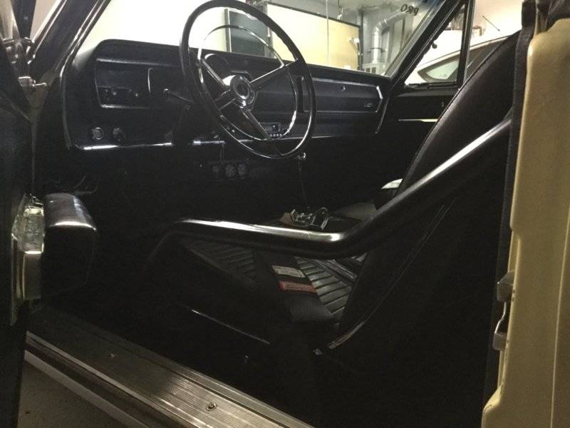

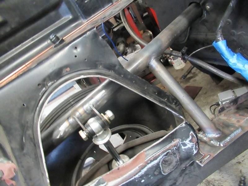

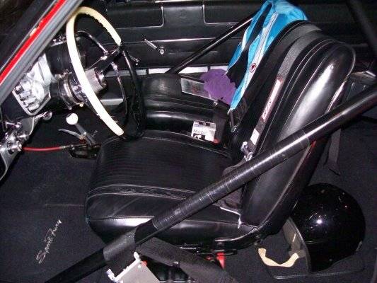

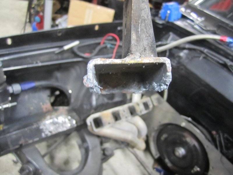

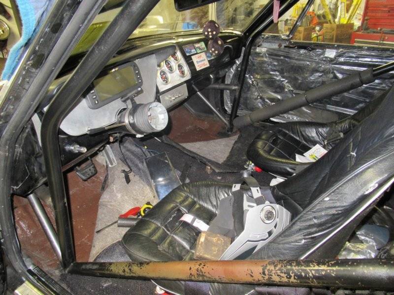

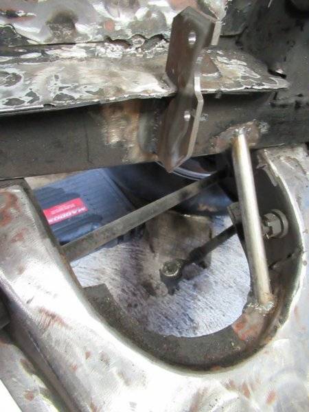

this is a 63 b body , and my bar with supports n cross bars in my 63 sf . soon to be a cage .
this is a 63 b body , and my bar with supports n cross bars in my 63 sf . soon to be a cage . View attachment 611763

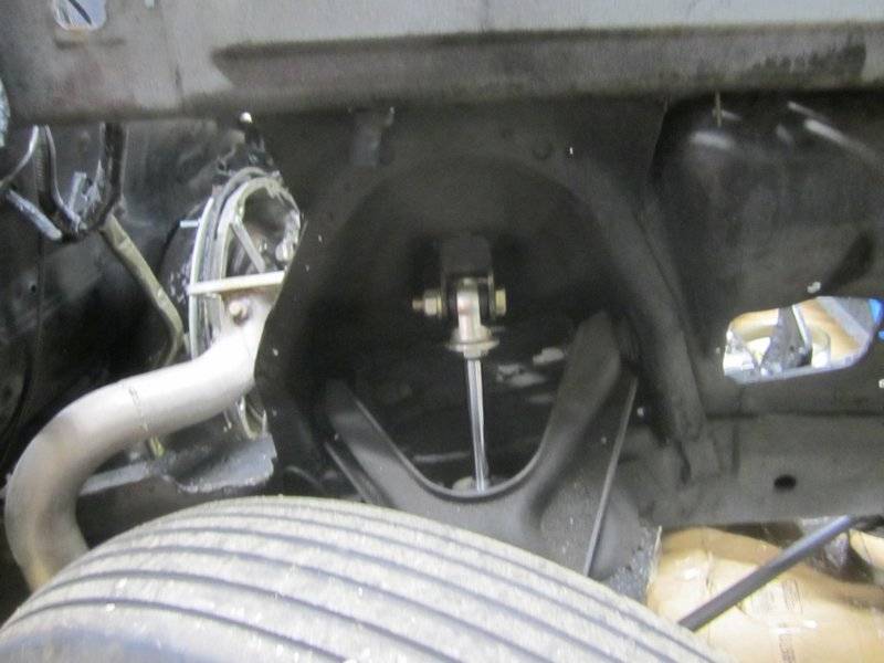

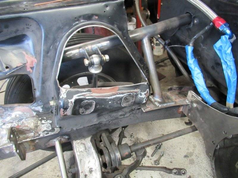

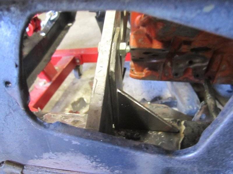

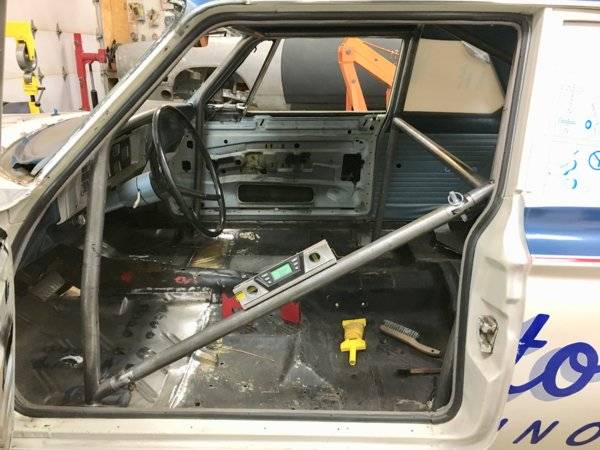

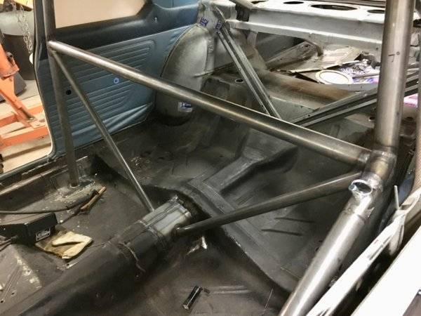

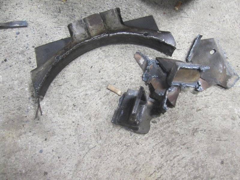

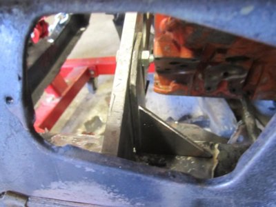

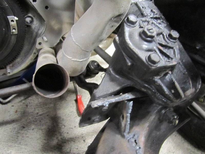

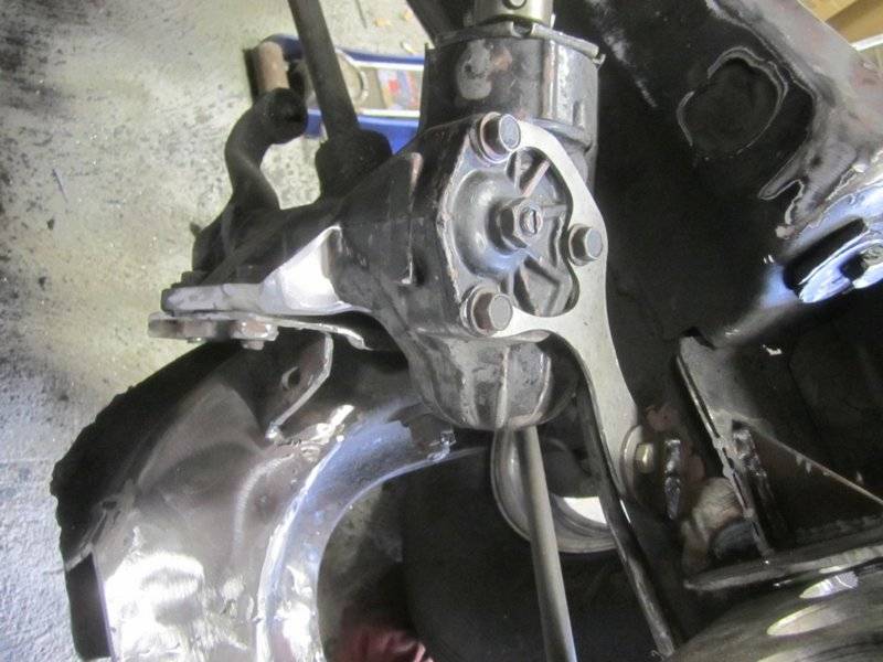

Did run a support down to the k and braced the steering box because there not much left of the steering box mount.Also changed the top shock mount location.

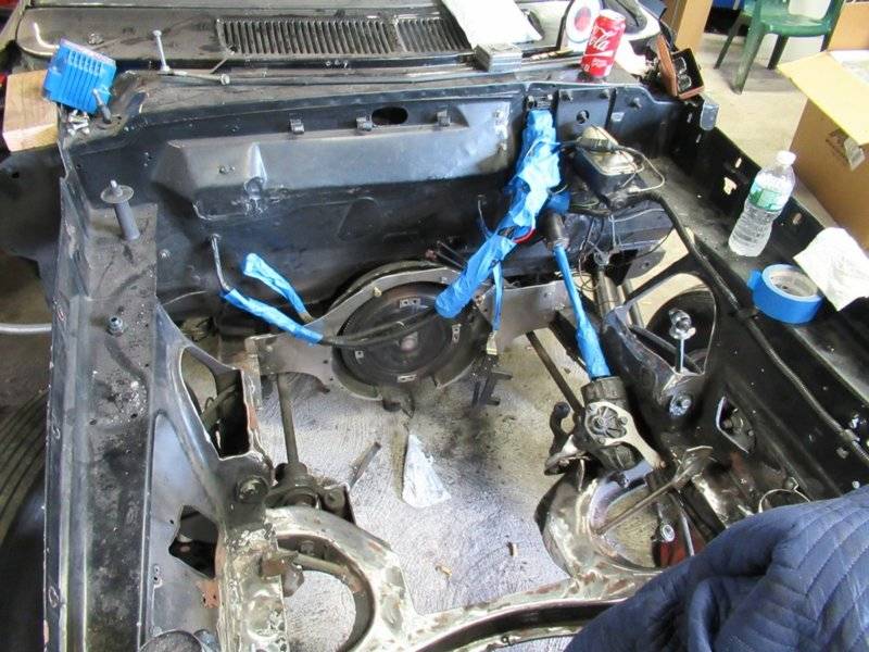

View attachment 612026 View attachment 612027 View attachment 612028 View attachment 612029 View attachment 612030 View attachment 612031 View attachment 612032 View attachment 612033 View attachment 612034 View attachment 612035

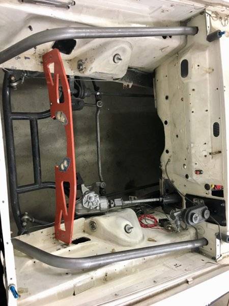

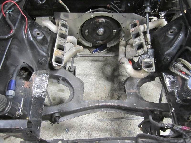

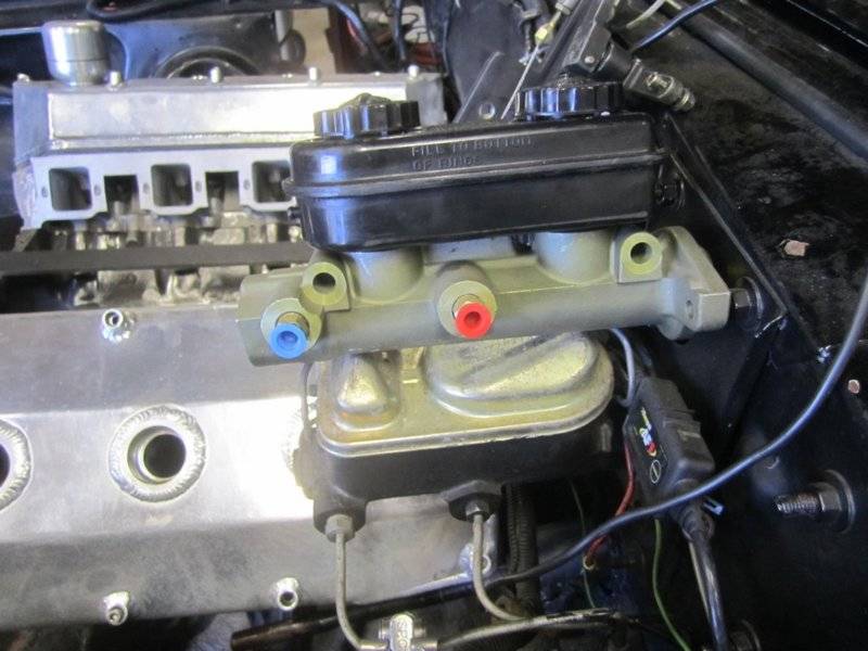

Midplate comes with 2 spacers,,,,,6 bolt & 8 bolt.
Midplate & "J" bars made a world of difference!
