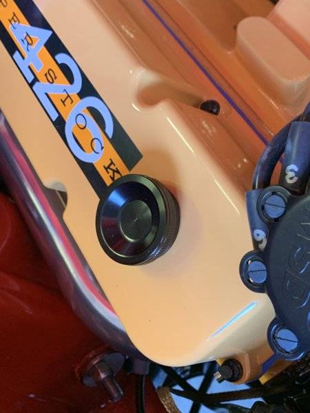

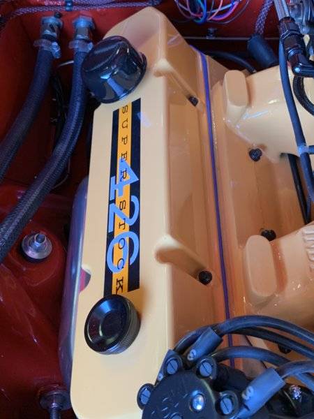

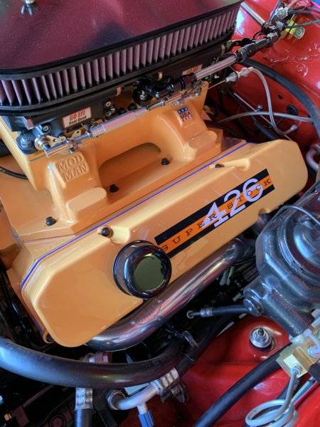

I purchased cast aluminum valve covers from Marsh Performance. They clear my 1.6 roller rockers easily. They came with baffled holes for a breather and PCV grommet. I drilled another hole for a screw on oil fill port. They come polished but I elected to paint mine. Very good quality and affordable. I use the Moroso gaskets as well. No leaks.MOPARTS@PTMC.NET Todd Marsh
