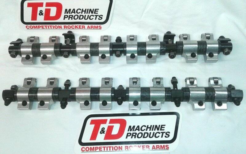

Comp 1516’s are T&D’s
Comp 1071/1073 are HS

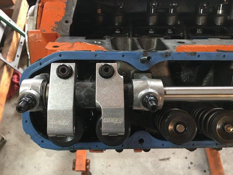

thats interesting,,i have an email into comp on the 1516's on what they can take open spring pressure wise but have not heard anything,,with a .250 offset they would work,,any thoughts on what u think they can handle ?
Now that Dwayne mentions it, those rockers do look likeT&D. If the picture is accurate, it looks like a one piece shaft bracket to take the place of the individual stands. I don't know if they require more machine work on 286 heads.
If those are T&D (I do not doubt Dwayne at all!) I would be surprised if they can't handle 800lb springs.
i agree, but getting useful info from those sites is almost impossible, if thats the case with the shaft brackets it mite just bolt on without the OEM max stands..But it never goes that easy at my house !

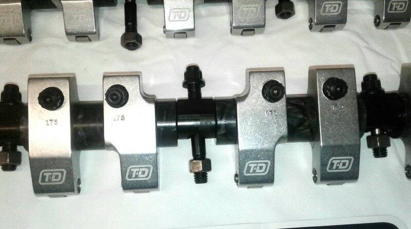

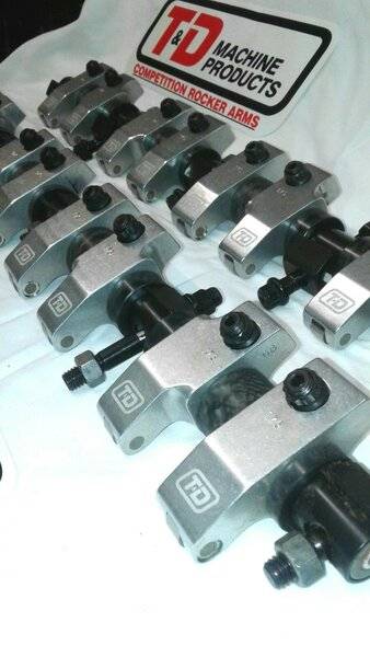

yep,,called t&d today and confirmed, CC 1516 and t-d 8200 r the same..and the picture is generic, does not have the lower shaft bracket attached, comes std like all the others with rockers, shafts, bolts and hold downs with spacers...heres a pic of a guy selling them on ebay #8201,,except they r 1.75 ratio, good luck with that sale...And they said people r using these regularly on stage 1-2 max heads, and can handle up to 1000lbs open spring pressure..ordered a set thru summit...anybody interested in a set of RAS 1.6 SS roller rockers brand new will fit trickflow heads....i no longer need mine.

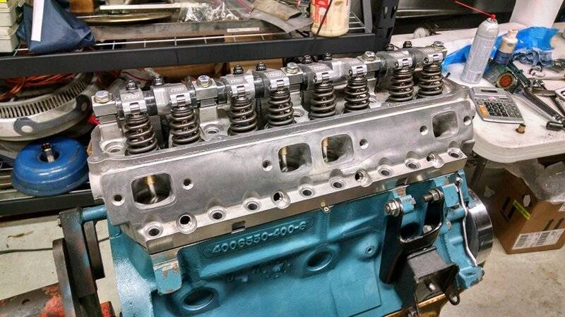

recieved the T&D 8200 rockers,,they clear the heads, barely..oddball shaft size at .750. stock spacers r over .100 larger. these come with a nylon type spacers. its mocked up with a combination of both but the originals can move up and down on the shafts an 1/8 inch.. and so far i have not seen any avialable..but the thing i am most concerned about is pushrod to rocker angle..ball/ball..the stock iron units have an angle to them in relation to the tip,,appx 20-30 degrees..these r straight across, thus increasing the angle at 0 lift..
recieved the T&D 8200 rockers,,they clear the heads, barely..oddball shaft size at .750. stock spacers r over .100 larger. these come with a nylon type spacers. its mocked up with a combination of both but the originals can move up and down on the shafts an 1/8 inch.. and so far i have not seen any avialable..but the thing i am most concerned about is pushrod to rocker angle..ball/ball..the stock iron units have an angle to them in relation to the tip,,appx 20-30 degrees..these r straight across, thus increasing the angle at 0 lift..View attachment 1171945
I have the .650 offset T&D I had to move the different thickness plastic spacers different than the way they came in the package, & the adjusters are to be about 1.5 to 2 turns from the top of being all the way UP iirc,read the directions it has to do with the oil hole in the adjuster, I also have the B3 racing geometry correction spacers, I know you have the mounting blocks where mine are the stock as cast
You should have asked T&D about the stands.
They would have the correct size hole for their shafts.
i did talk to t&d about them but they are out 16 weeks for new orders but summit shipped them right away thru CC...never thought about shaft size and they did not say anything either,,they shipped with steel bushings to fit the stands o.k. so its just a matter of finding the correct size spacers..but i'm thinking of raising the stands some way,,either by shims ? or having new 1's made that r taller..i have seen stand shims in the past but cant remember where... taller 1 piece stands would probably be better....
I believe B3 can make custom billet stands, to move the shaft where you want it. Id give him a call. Thats who i would trust to get you in the right place.
B3 and HS both will,,i had to order a new PR lenght checker, be here wednesday to mock it all up with the lite weight springs and check the pattern and angle. will put various thickness washers under the stands and go from there, thanks!

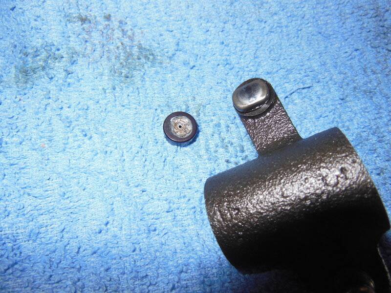

check out this pic,,this is only after appx 200 street miles running VR1 high zinc oil With the lucas oil additive on new CC lash caps, 60lbs oil pressure at idle. 80ish going down the road at 3200 rpm's. 500lbs open spring pressure. they r all this way to a certain degree, i may have to have the valve stem tips re-machined. original max wedge rockers will Not be going back on..
