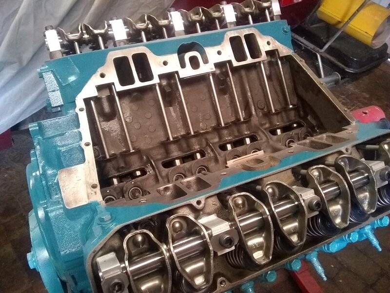

I was running those exact crane gold offset rockers on a roller cammed maxwedge head engine (286 head). I had no problems with the rockers or stands, once i got the pushrod length right. But since I have two sets of 286, I made myself a set of 6061 billet stands with better and more material. They were beautiful! Maybe I will find them some day.

Like these?

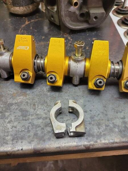

what happened to your rocker stand ? too weak for roller cam spring pressures ?
the stand broke because the bottom end blew apart. It was a 275 @50 solid
