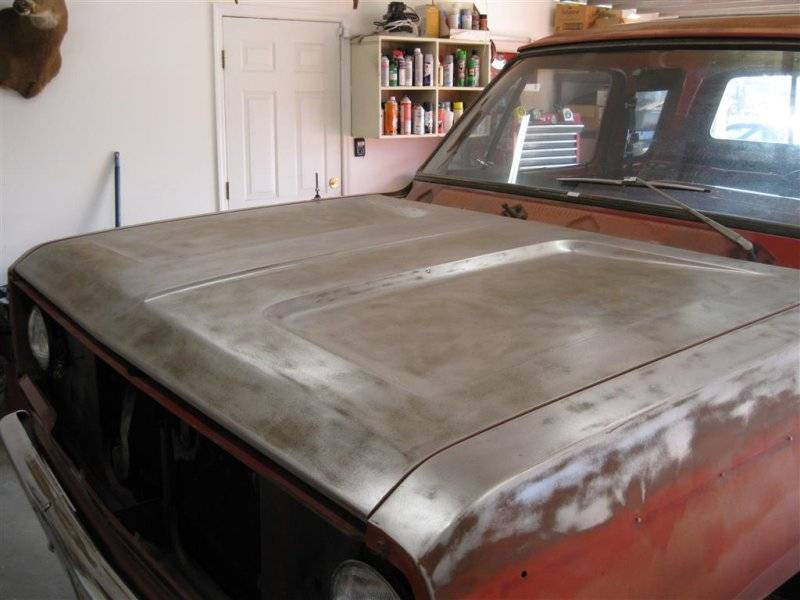

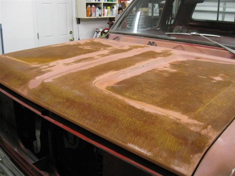

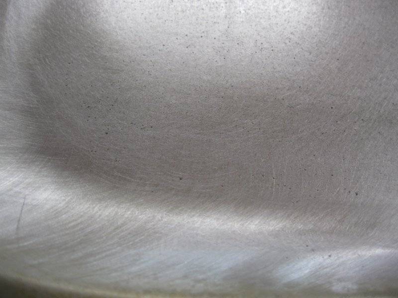

Yup this. Remove that nice stainless first and mask off the glass real good so you don't scratch it up. My Power Wagon was the same way sun baked and rusty. Even after getting it to shiny metal there will still be pits, see last pic. Treat them then neutralize the metal, epoxy prime with good stuff like SPI or DP90.

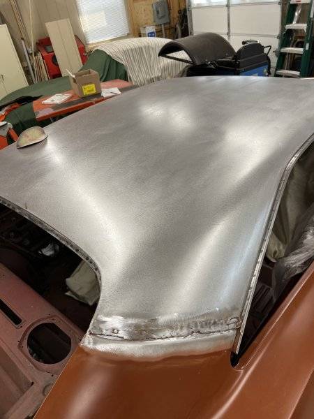

I appreciate all the replies and advice, I am trying some of these on some of the rougher spots on my deck lid and so far they look pretty solid, but we will see after I primer and block them a few times.

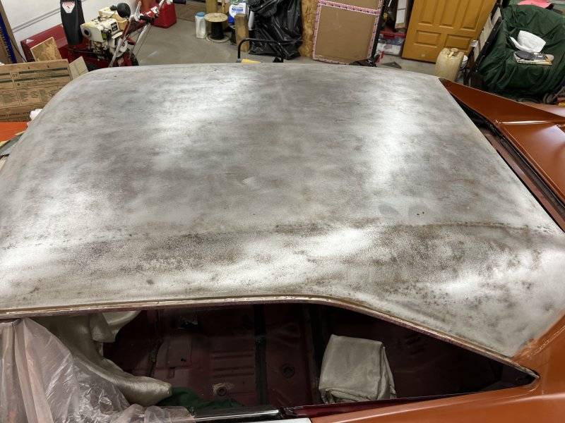

Sanded the roof with 80. Was left with lots of pits. Home Depot metal and concrete prep eats down into them.
After it’s all done doing it’s thing and cleaned/neutralized I went over it with 80 to guarantee to myself that all it’s residue is gone. Then prime it up.
